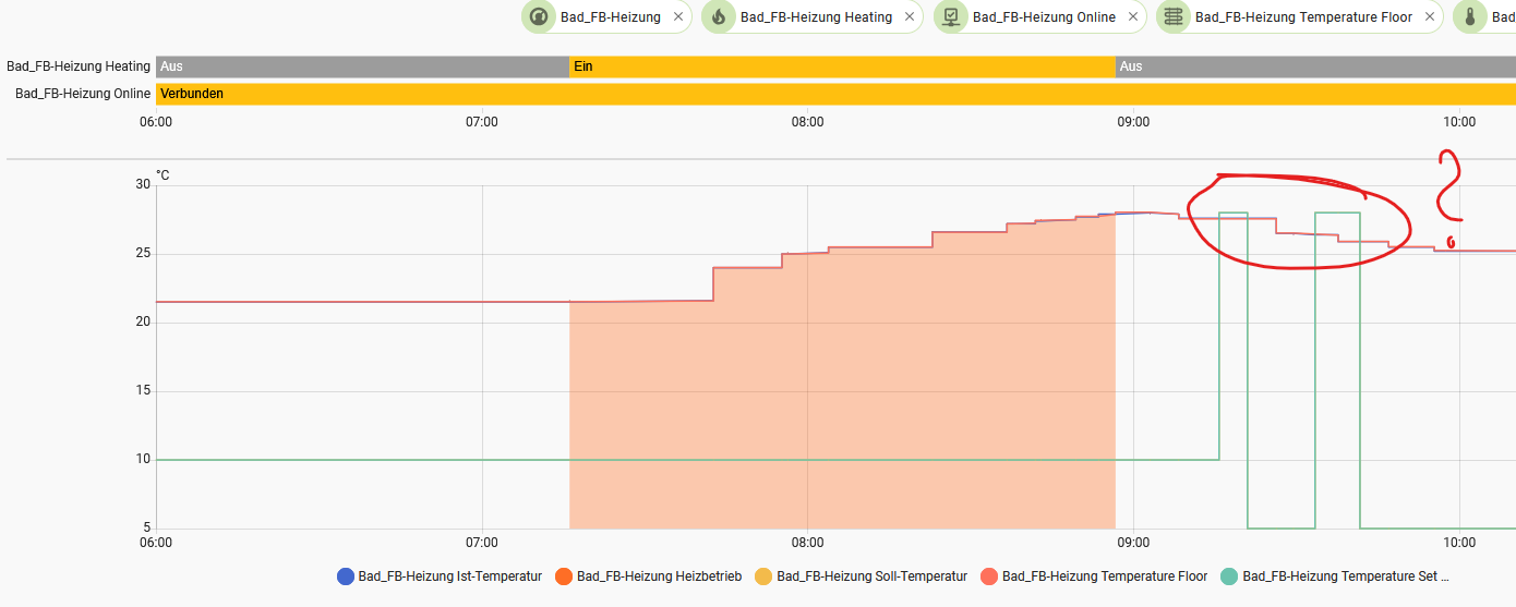

Has anyone gotten nice steady readings from the thermostat?
All the data since installation has been like this. I have now netwatch in place in my router to ping the thermostat and ocd5.azurewebsites.net to see if there is a pattern in link downs related to cut graph data.

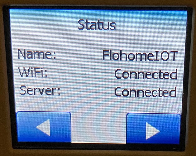

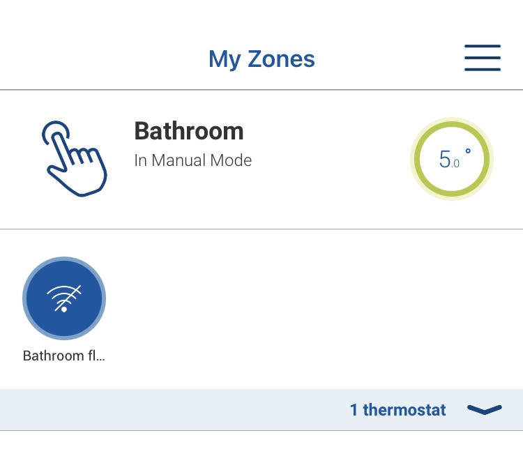

Since 3hrs, feb1 2026 16:55hrs(UTC+1), it looks like the service is down.
In the app I get an icon with wifi signal with a crossed line.(see screenshot) although the Thermostat device itself does say it is connected to local Wifi and to the server.(see 2nd screenshot).
Couple of weeks ago, when I contact OJ for another issue, they said that the ‘servers’ were having issues…
Again a cloud regulated device going to die.
The more important to go for devices with local API access!
EDIT: Since 1945hrs, the integration came to life, just as the App!
Service outage of almost 3hrs.:disappointed_relieved:
