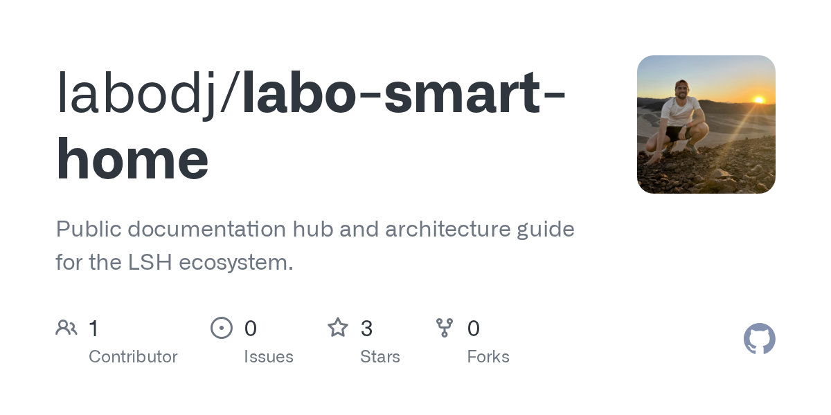

I also documented the hardware side separately here:

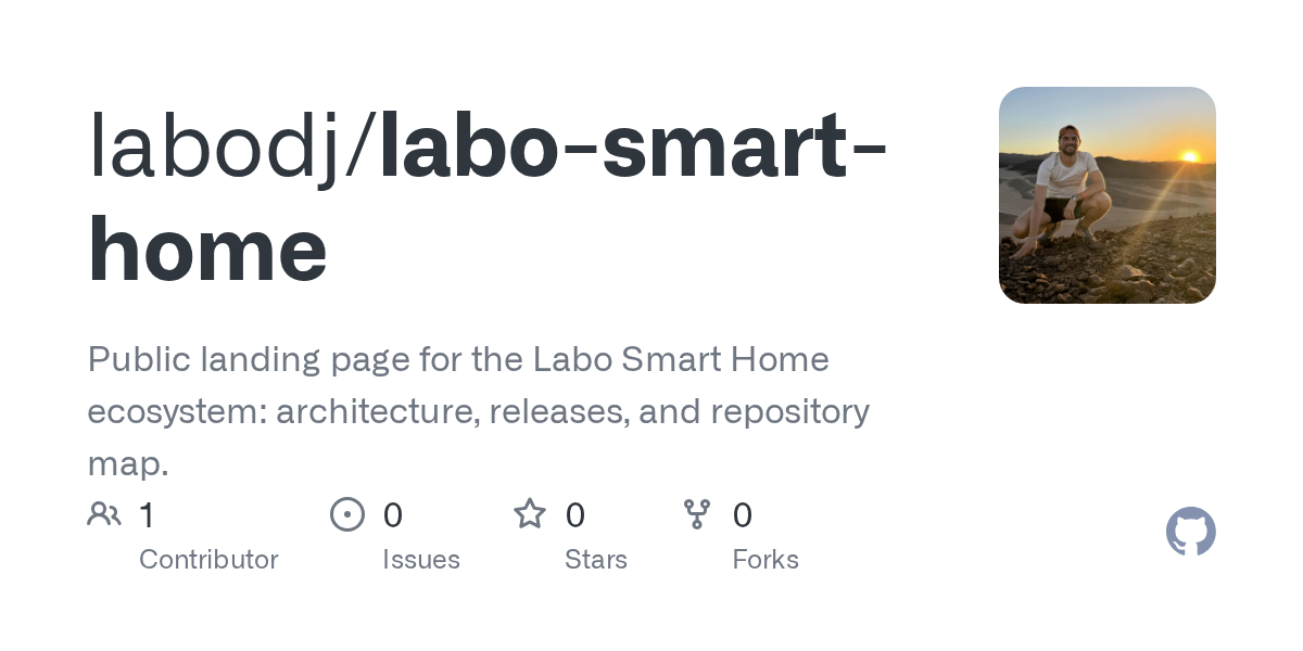

The updated landing page is here:
The goal is still the same: keep the wired controller side local and predictable, while making the public pieces easier to inspect, install and try independently.

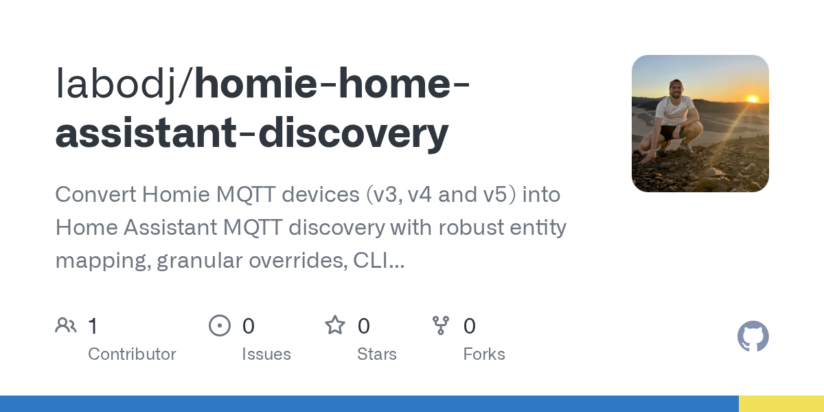

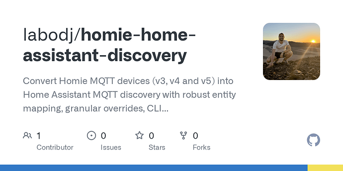

Home Assistant MQTT discovery has been moved out of LSH into a generic Homie discovery package:
There is also a separate Node-RED wrapper for that discovery path:
That split is probably the most relevant part for Home Assistant users who do not care about the whole LSH stack.
The discovery package listens to Homie MQTT metadata and publishes retained Home Assistant MQTT discovery payloads. It supports Homie v3.0.1, v4 and v5, and the mapper is deliberately conservative: it handles common cases automatically, but it does not try to guess complex Home Assistant domains from generic Homie metadata alone.
When the metadata is not specific enough, overrides can be used for stable IDs, names, platforms and entity-specific details.
