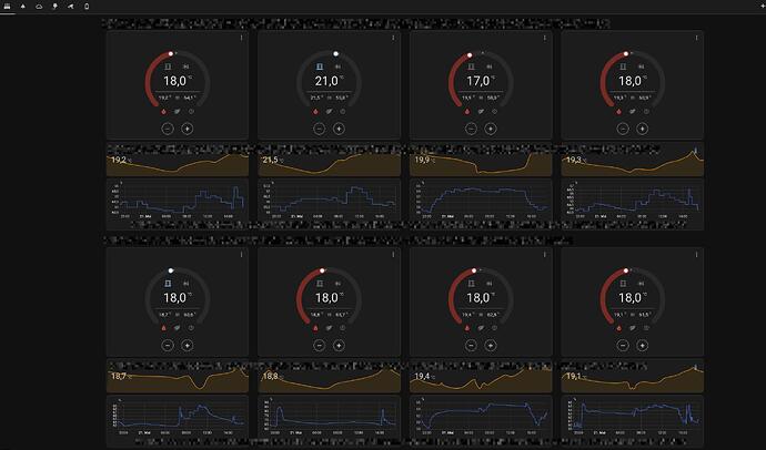

the number of smart thermostats I have has grown over time, and this is my current dashboard for them.
If you scroll down a bit further, there are another eight thermostats listed. How can I get this under control, or how can I create a much clearer dashboard for the thermostats?
A breakdown by floor would be great, from the basement to the attic. But what’s the best way to do this? Do you have any ideas? I don't need something fancy just as practical as its get.
These are Better Thermostat UI Cards. Unfortunately, it’s very easy to accidentally adjust a thermostat on your mobile.
A single thermostat generally shows several pieces of information:
  • If heating/cooling is currently active.
  • The target temperature.
  • The current room temperature.
When someone looks at the dashboard, is it important that they see all of that information for all thermostats?
For example, would a smaller dashboard that just showed the current temperature in every room and if cool/heating is active be sufficient for your needs?
I.e. Could you create smaller dashboards that are specific to specific functions/needs?

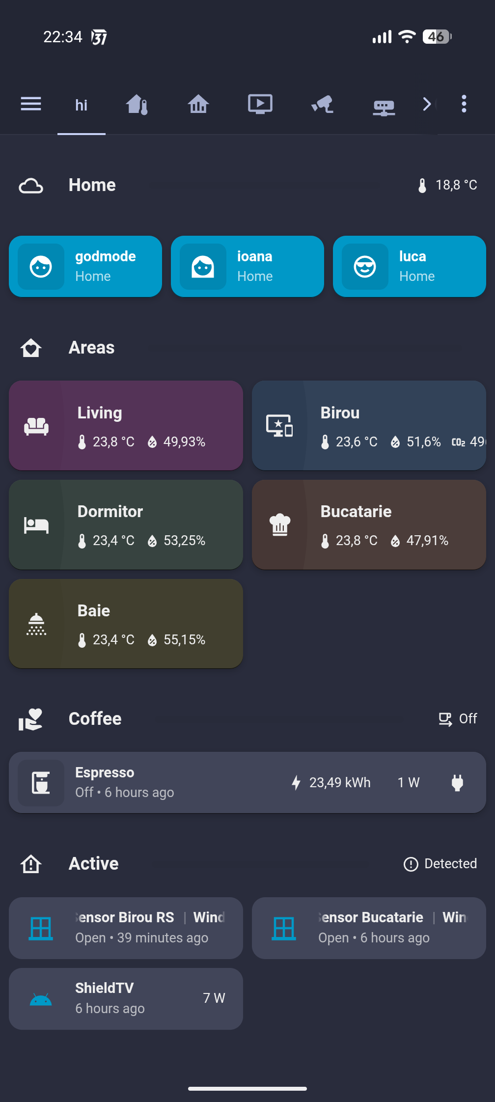

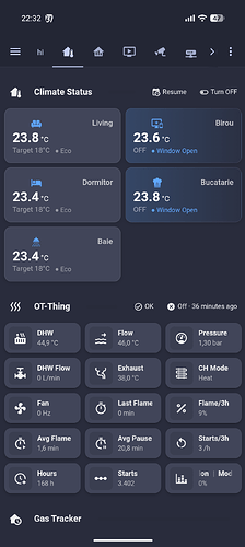

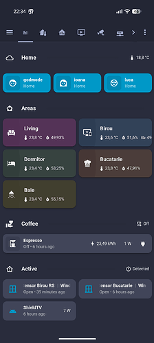

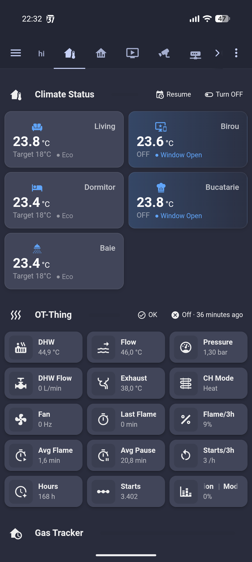

You can get into theming and customizing them. Explore the forums or github there are so many nice things. It does take some time to make them how you want though.
Example, Im using Bonbon Strategy which uses Bubble Cards. It looks like this. Good luck!
