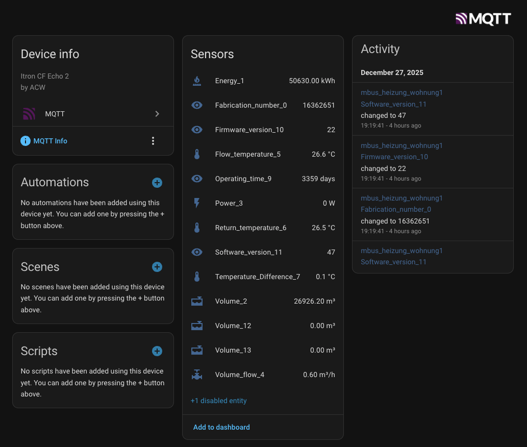

As I struggled to find an easy m-bus implementation, I created marcofl / mbus2mqtt Home Assistant · GitLab today. It uses libmbus (GitHub - rscada/libmbus: Meter-bus library and utility programs) commands that you can freely define, you get a docker image with libmbus tools compiled to scan and play around - see README. Once you have a working command that gives you the xml for the meter you query, you simply use that command. then it sends all data records to mqtt including home assistant auto discovery.
It’s a proof-of-concept working for my use case, but it might be useful already, I don’t know.
What I do next here is either figure out how to map the units and scaling that are in the xml from libmbus into HA units (currently all sensors have no units) automatically or implement a config/mapping file / env vars to map sensors to units and scaling.

you can use any libmbus request-data command in MBUS_REQUEST_CMD env variable, as long as it outputs in the format you see in “example-data.xml”
Files · 0.1.0 · marcofl / mbus2mqtt Home Assistant · GitLab fixes value flow metrics (used wrong device_class) and improves logging.
