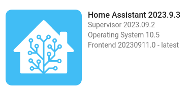

And lastly, some version information
Screenshot from 2023-09-28 14-46-42
