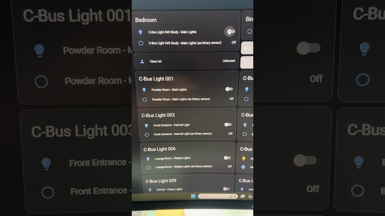

Hi @Samsonsite,
Firstly, thank you for all your effort in creating this add-on
I have installed your cmqttd add-on & Mosquito Mqtt connected via a PCI serial to USB interface. All per your instructons (This is not using a docker, it is directly on HAOS). All my cbus lights are showing and they turn on and off on the HA web interface (dashboard) i.e. you switch a light entity on the the bulb turns yellow and the boolean says ā€œONā€ and conversely the opposite when I turn it off, but the lights in the house donā€™t physically change state, nor is their actual status showing on the dashboard. I have confirmed that my serial to USB cable is ok as I can turn lights on and off using the cbus toolkit directly.
See video here:
Iā€™m at a loss as to what to do next, can you assist?
