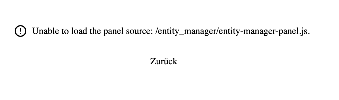

Get this after installation. Rebooted multiple times but no luck
I’ll take a look when im home. Does the card work?

No, the card doesn’t work. It does not show up in card picker
Integration is installed, sidebar has the entry.
I’ll try uninstall, reboot and new install later

The sidebar should be working now. This is still a work in progress…
