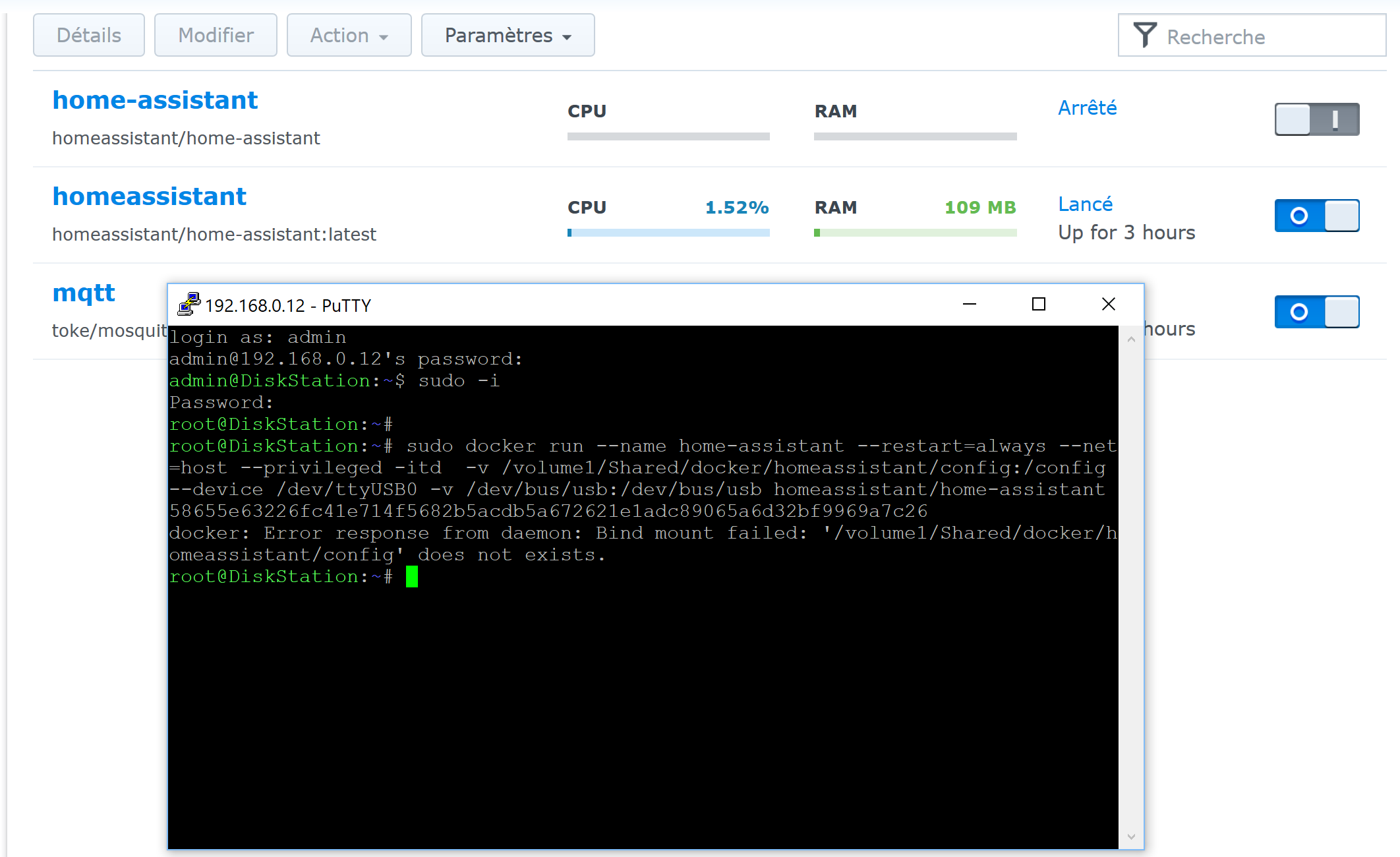

I have seen this code from http://philhawthorne.com.
sudo docker run --name home-assistant --restart=always --net=host --privileged -itd  -v /volume1/Shared/docker/homeassistant/config:/config --device /dev/ttyUSB0 -v /dev/bus/usb:/dev/bus/usb homeassistant/home-assistant
After i enter this code i get an error and a new home assistant container in docker.
Maybe this can help you to troubleshoot my issue.
Thanks.
Did you create the directories you are mapping your container too?
If we break down the command you ran…
The extract below is mapping the container to a local folder.
To keep the command the same create a new shared folder on your Synology called “Shared” and within that create a folder called “Docker” then within that a folder called “homeassistant”
This is where your HomeAssistant configs will live.
Hello jamieb. Thank you for you response.
Correct me if i’m wrong but if i can use bluetooth_tracker and discover some devices it sould mean that my container already have access to the usb bus?
So now i have two different installation of HA on two different containers.
I moved the files from my previous config to the new container but it’s not working i’m having the same issue.
