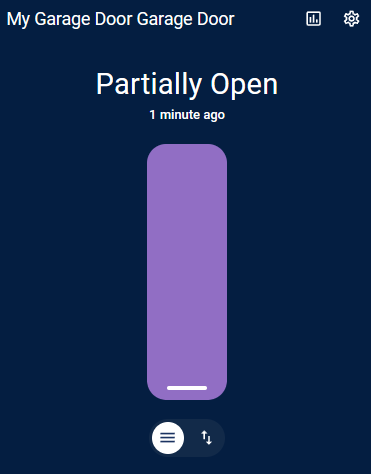

My Garage Door: I have cover states Open, Opening, Closing and Closed using a D1 Mini and two reed switches plus a WS2812 LED strip indicating parking position
Post your whole config. Binary sensors as well
I’d like to point out that I also don’t want inferred endstops as then the cover would appear to be fully open/closed after the opening/closing duration completes but I might have stopped it midway or it hit an obstacle and reversed.
Here’s the config as it stands now:

With your logic, I do not see opening/closing when operating the door outside of HA, only when opening/closing within HA. Additionally, the closed contact sensor logic is backwards now and it only shows Closed when I remove the magnet from the bottom sensor after I’ve introduced it.
Righy. When you trigger the door outside of HA, its outside of HA, so thats to be expected. Did you remove the movement sensors? Lets try to get the basic functions working first.
How many contacts are on the reed switch? It should say on them NO, COM, NC. How are you wiring them? Are they both the same?
The reed switches are just two wire on/off and each are NO.
With a movement sensor defined as the inverse of the opposing contact sensor, I can detect opening/closing external to HA and the cover states behave correctly in HA:
Door open switch = on & Door closed switch = off: Open
Door open switch = off & Door closed switch =off: Closing %
Door open switch = off & Door closed switch =on: Closed
Door open switch = off & Door closed switch =off: Opening %
Door open switch = on & Door closed switch =off: Open
or
or
or
The key element was setting has_built_in_endstop: true so that the door motor switch was not activated when the cover presumed the door was open/closed which would have had adverse effects. But I do need the movement sensors for external feedback…

Note the duty_time sensor to turn off the light after a fixed time period after opening is case I leave the door open for an extended period. I am going to do more testing before boxing it up an installing it but it’s coming along nicely I think, finally!
Oh, here are the trigger level input numbers:
My new automation in HA…
alias: My Garage Door - "Stalled"
description: ""
trigger:
  - platform: state
    entity_id:
      - binary_sensor.my_garage_door_is_closing
      - binary_sensor.my_garage_door_is_opening
    for:
      hours: 0
      minutes: 0
      seconds: 20
    to: "on"
condition: []
action:
  - service: python_script.hass_entities
      action: set_state
      entity_id: cover.my_garage_door_garage_door
      state: Stalled
      action: delete_attribute
      attribute: current_position
mode: single
I changed my mind…
description: ""
trigger:
  - platform: state
    entity_id:
    for:
      hours: 0
      minutes: 0
      seconds: 20
    to: "on"
  - platform: state
    entity_id:
    for:
      hours: 0
      minutes: 0
      seconds: 20
    to: "on"
condition: []
action:
  - choose:
      - conditions:
          - condition: trigger
            id:
              - Closing
        sequence:
              action: set_state
              state: Partially Closed
      - conditions:
            id:
              - Opening
        sequence:
              action: set_state
              state: Partially Open
mode: single
