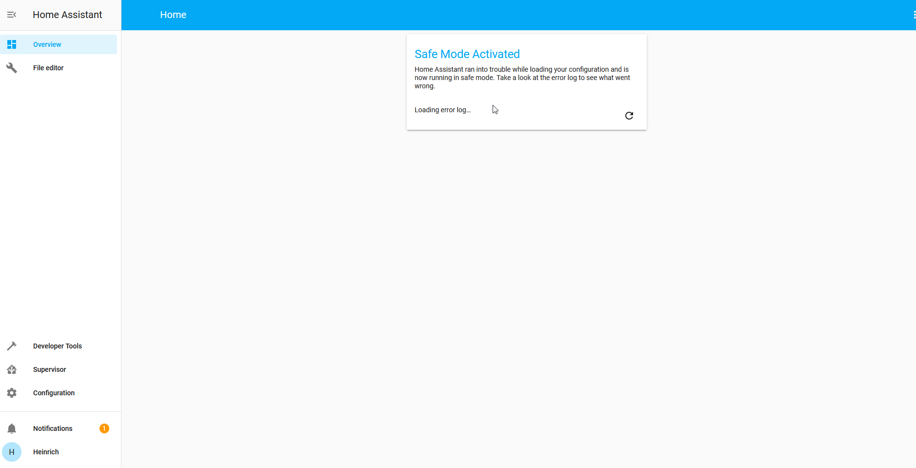

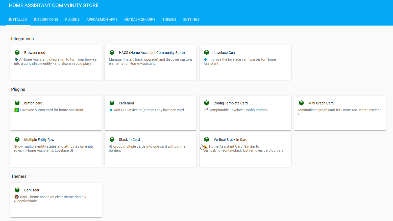

@klogg Ok here’s what i have on a brand new HA install. I used the folder structure as is and haven’t edited any of the files. All i’m hoping to achieve is only to at least get LoveLace to load up.
108.8
  • Installed hacs and added the custom integration and cards you mentioned. After adding each one i’m being presented to add them to lovelace
Here’s my full config.yaml file

I copied the lovelace directory as is
I copied the package directory to packages
I created a ui-lovelace.yaml file to include view_garden_version2.yaml
When reloading HA - System goes into recovery mode. Also Loading error log doesn’t load any logs
Looking at the log file from File Editor
2020-04-24 01:07:13 WARNING (MainThread) [homeassistant.loader] You are using a custom integration for hacs which has not been tested by Home Assistant. This component might cause stability problems, be sure to disable it if you experience issues with Home Assistant.
2020-04-24 01:07:14 ERROR (MainThread) [homeassistant.setup] Error during setup of component lovelace

    return yaml.load(conf_file, Loader=SafeLineLoader) or OrderedDict()
  File "/usr/local/lib/python3.7/site-packages/yaml/__init__.py", line 114, in load
    return loader.get_single_data()
  File "/usr/local/lib/python3.7/site-packages/yaml/constructor.py", line 51, in get_single_data
    return self.construct_document(node)
  File "/usr/local/lib/python3.7/site-packages/yaml/constructor.py", line 55, in construct_document
    data = self.construct_object(node)
  File "/usr/local/lib/python3.7/site-packages/yaml/constructor.py", line 100, in construct_object
    data = constructor(self, node)
  File "/usr/src/homeassistant/homeassistant/util/yaml/loader.py", line 195, in _ordered_dict
    nodes = loader.construct_pairs(node)
  File "/usr/local/lib/python3.7/site-packages/yaml/constructor.py", line 155, in construct_pairs
    value = self.construct_object(value_node, deep=deep)
  File "/usr/src/homeassistant/homeassistant/util/yaml/loader.py", line 226, in _construct_seq
    (obj,) = loader.construct_yaml_seq(node)
  File "/usr/local/lib/python3.7/site-packages/yaml/constructor.py", line 408, in construct_yaml_seq
    data.extend(self.construct_sequence(node))
  File "/usr/local/lib/python3.7/site-packages/yaml/constructor.py", line 130, in construct_sequence
    for child in node.value]
  File "/usr/local/lib/python3.7/site-packages/yaml/constructor.py", line 130, in <listcomp>
  File "/usr/src/homeassistant/homeassistant/util/yaml/loader.py", line 114, in _include_yaml
    fname = os.path.join(os.path.dirname(loader.name), node.value)
  File "/usr/local/lib/python3.7/posixpath.py", line 94, in join
    genericpath._check_arg_types('join', a, *p)
  File "/usr/local/lib/python3.7/genericpath.py", line 153, in _check_arg_types
    (funcname, s.__class__.__name__)) from None
TypeError: join() argument must be str or bytes, not 'list'
2020-04-24 01:07:14 ERROR (MainThread) [homeassistant.setup] Unable to set up dependencies of frontend. Setup failed for dependencies: lovelace
2020-04-24 01:07:14 ERROR (MainThread) [homeassistant.setup] Setup failed for frontend: Could not set up all dependencies.
2020-04-24 01:07:14 ERROR (MainThread) [homeassistant.setup] Unable to set up dependencies of hacs. Setup failed for dependencies: frontend, lovelace
2020-04-24 01:07:14 ERROR (MainThread) [homeassistant.setup] Setup failed for hacs: Could not set up all dependencies.
2020-04-24 01:07:14 ERROR (MainThread) [homeassistant.setup] Unable to set up dependencies of map. Setup failed for dependencies: frontend
2020-04-24 01:07:14 ERROR (MainThread) [homeassistant.setup] Setup failed for map: Could not set up all dependencies.
2020-04-24 01:07:14 ERROR (MainThread) [homeassistant.setup] Unable to set up dependencies of logbook. Setup failed for dependencies: frontend
2020-04-24 01:07:14 ERROR (MainThread) [homeassistant.setup] Setup failed for logbook: Could not set up all dependencies.
2020-04-24 01:07:15 ERROR (MainThread) [homeassistant.setup] Unable to set up dependencies of default_config. Setup failed for dependencies: frontend, logbook, map
2020-04-24 01:07:15 ERROR (MainThread) [homeassistant.setup] Setup failed for default_config: Could not set up all dependencies.
2020-04-24 01:07:20 WARNING (MainThread) [homeassistant.bootstrap] Detected that frontend did not load. Activating safe mode

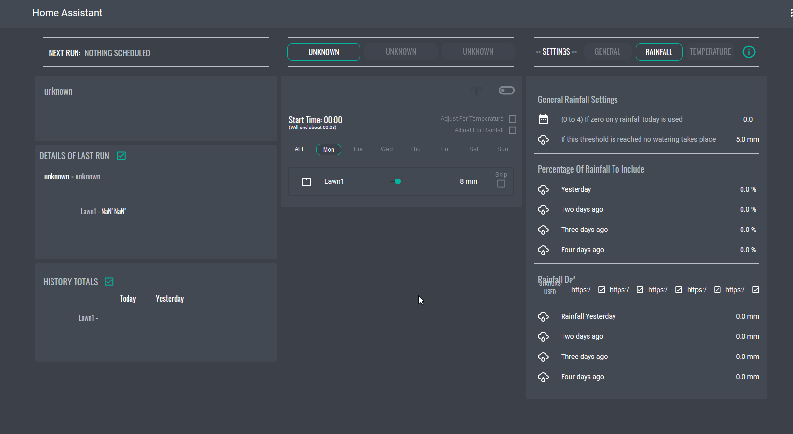

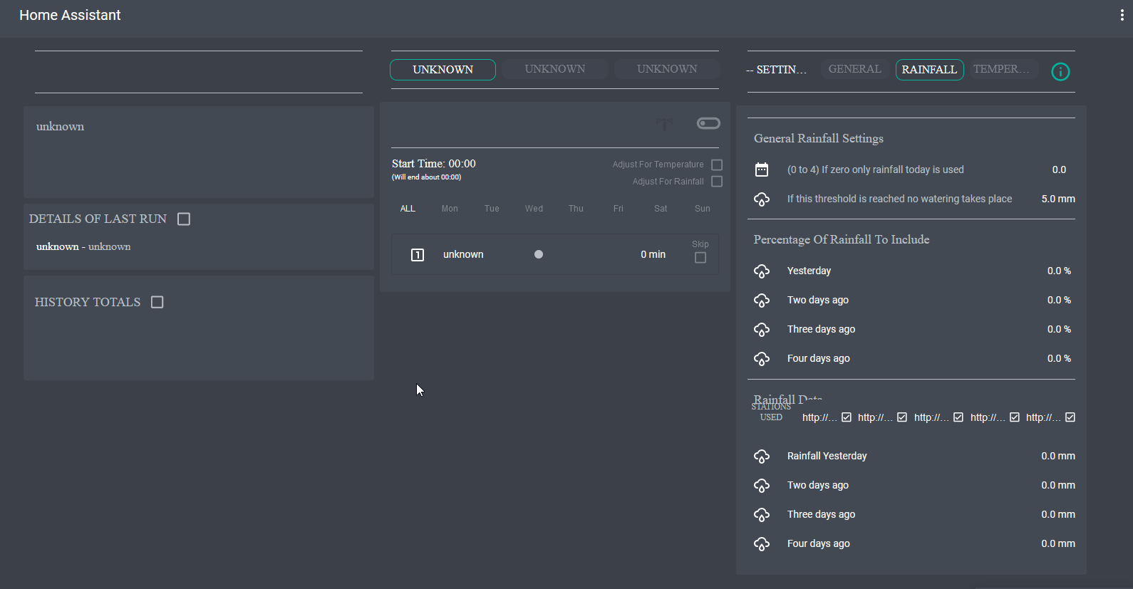

@klogg Thank you so much for taking the time to read through my comments.
Here’s what i have. I’ve been through the prerequisites and the only thing i haven’ done is the notifications
  • HACS cards installed and defined as indicated on each of the respective install pages.
  • Oswold font set
  • dark_teal theme set
  • Darksky have been added however not too sure if these are 100% correct:
  -  platform: darksky
     api_key: <apikey>
     forecast: 1
     monitored_conditions:
     - summary
     - temperature
     - temperature_max
     - temperature_min
     - cloud_cover
     - humidity
     - pressure
     - minutely_summary
     - hourly_summary
     - daily_summary
Overall:
  • System IDLE is unkown
  • Morning Afternoon and Manual is Unkown - Where is this being defined or being pulled from?
Because the file “view_garden_v2.yaml” must be in the /config directory. And also the two directory “includes” and “includes_garden” must be in te /config directory.
