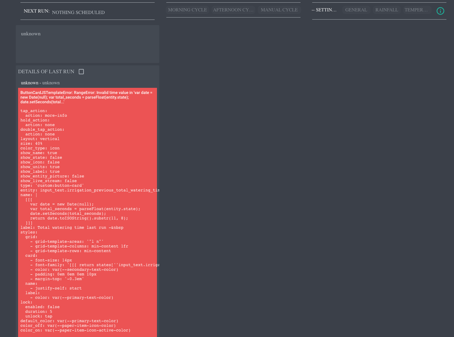

I’ve copied the project to their respective folders and I’ve followed all the prerequisites as in here including input_text.notifications_user1_name and input_text.notifications_user2_name
I don’t know if the issue is related to smartweather that I’ve not set.

I’ve looked at your log and I have a few observations (none of which necessarily point to the problem!)

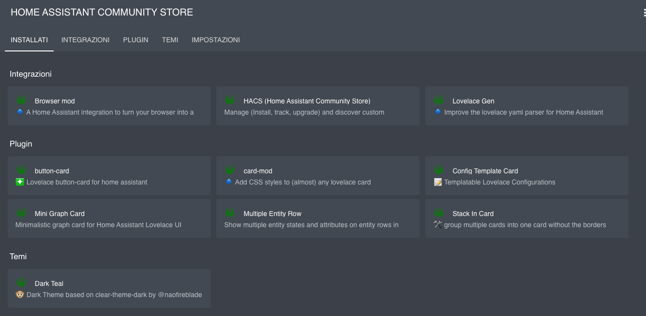

Do you have browser_mod and lovelace_gen installed because I get this in my log:
2020-04-28 10:11:33 WARNING (MainThread) [homeassistant.loader] You are using a custom integration for lovelace_gen which has not been tested by Home Assistant. This component might cause stability problems, be sure to disable it if you experience issues with Home Assistant.
2020-04-28 10:11:33 WARNING (MainThread) [homeassistant.loader] You are using a custom integration for browser_mod which has not been tested by Home Assistant. This component might cause stability problems, be sure to disable it if you experience issues with Home Assistant.
All the errors arising from the config seem to be
ERROR (MainThread) [homeassistant.components.websocket_api.http.connection.1797713552] Error handling message: Unknown error
with the root cause being
TypeError: join() argument must be str or bytes, not 'list'
Which I don’t understand because I do not use ‘join’ in this package.
It must be struggling with something else becasue all the messages seem to point to a Lovelace error somewhere.
Do you get anything displayed at all on startup?
Perhaps you could narrow it down by removing parts of the main view.
There are three parts, ‘SYSTEM STATUS’, ‘SCHEDULES’ and ‘SETTINGS’
SYSTEM STATUS is itself made up of separate sections which can be removed independently.

I’ve never used the browser_mod and lovelace_gen plugins/integrations, so I haven’t added the two lines in configurations.yaml.

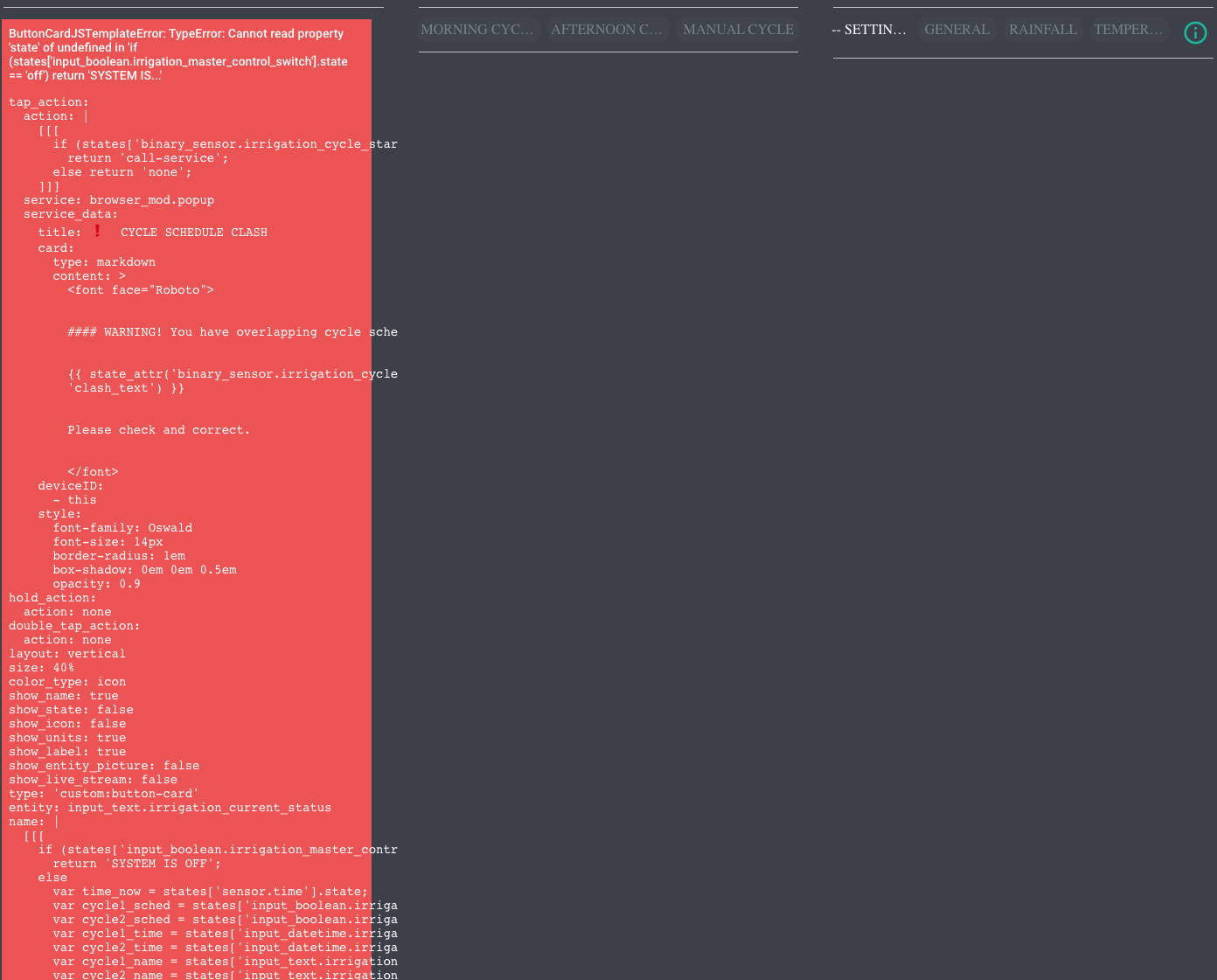

Now it shows something, but I get some errors.
These are the plugins/integrations installed
and this is the resources.yaml

Do you have sensor.time?
You also need
browser_mod:
In your configuration.yaml (you don’t need it in your resources).

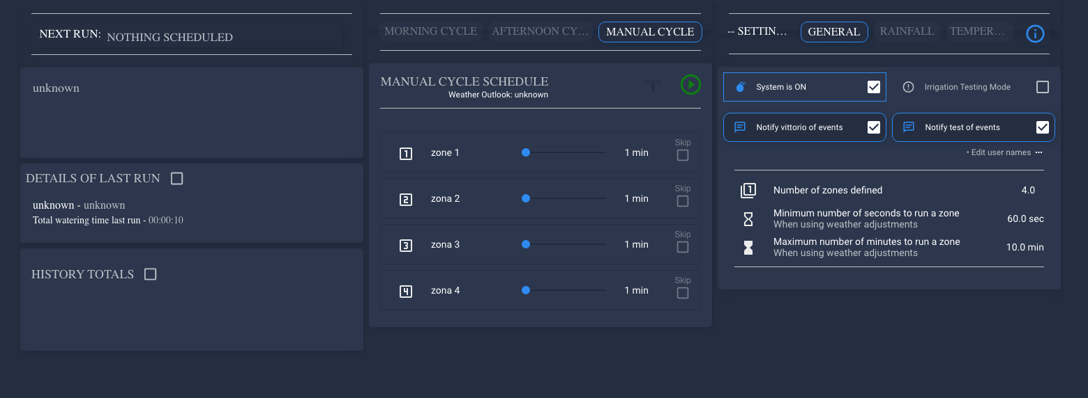

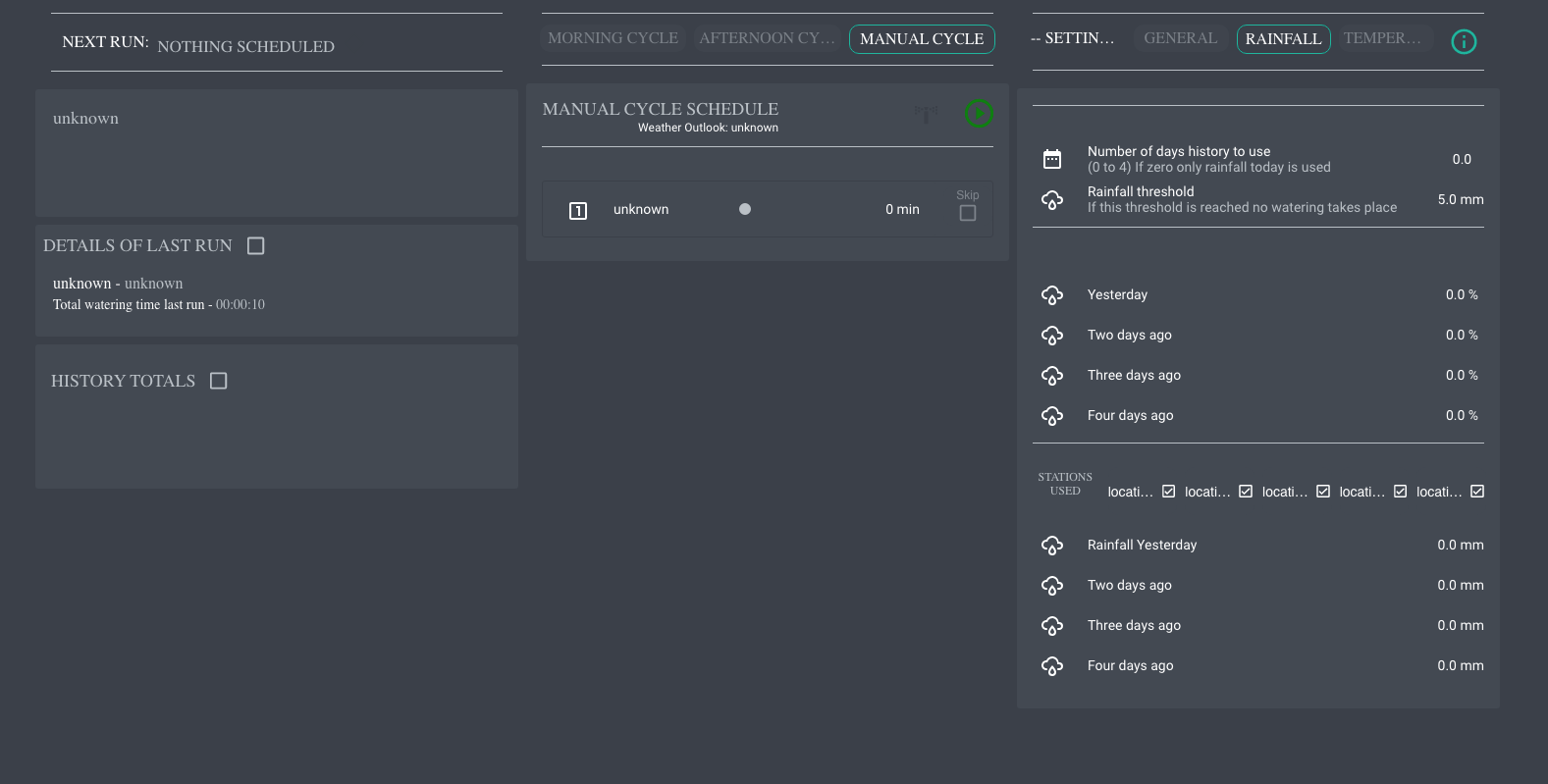

I found that this error is caused by input_text.irrigation_previous_total_watering_time that was unknown.
I’ve manually set (from States) to any value (10 in my case) and the error message disappeared.
So now I’m here

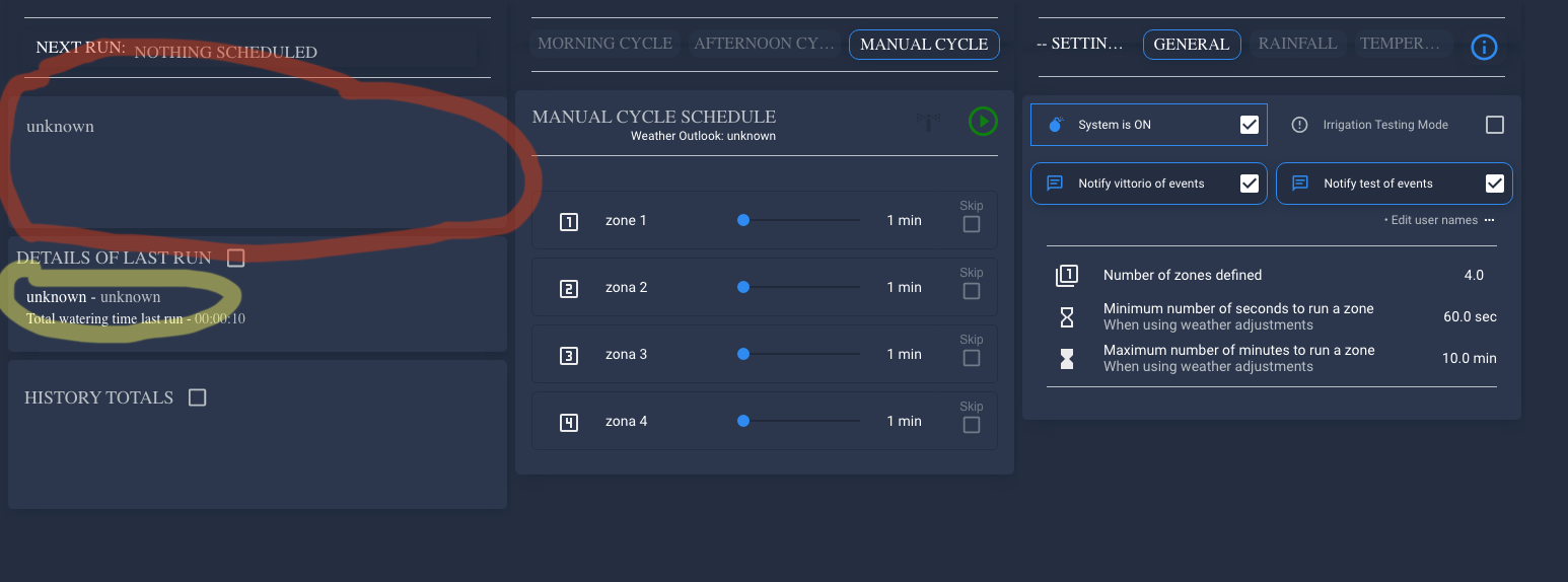

What can I check to understand why I have all that unknown and how can I fix it?
Three things you can do to start with:
  1. Set up Oswald font. Everything will display better with it.
  2. It looks like you don’t have the Dark Sky weather sensor set up correctly
  3. Click on the zone ‘unknown’ and you should be able to change the details for it
See the prerequisites for more details about these things.

  1. I’ve clicked on some part of the screen and I was able to change some values, but not on all the unknown (especially on the left side of the screen).
One strange thing is this, I have two HA tabs in the browser, one with the dashboard and one with the terminal (inside HA).
When I click on an item that is supposed to show a popup, the popup opens on the other tab.
I made a short video to show this

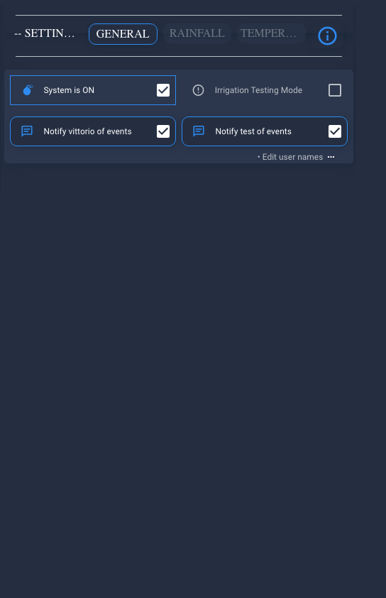

Is it possible to choose how many zones the project can manage? Should I change something in the code or is it possible to choose it in the panels?
I’m not sure you have read all of the prerequisites fully… :wink:
  1. There is no need to reduce the darksky sensor, I have just showed what the minimum is, but you will need to change a couple of lines of code or your sensor name.
  2. Choose the GENERAL options and then click on ‘Number of zones defined’.
  3. Popups will always appear on the most recent browser tab. There is nothing anyone can do about this. It is also documented in the Github for browser_mod.
  4. On the GENERAL settings page check that the ‘User Interface font’ is set to ‘Oswald’. If you don’t have that option then I suspect that you don’t have the latest version. I have recently made improvements to set some default values and am currently planning on expanding that section to make it easier for first use setup.
Ok for 1. and 3. ! I’ve read carefully the prerequisites page, but not so good the main installation page! :wink:
In the General tab I don’t see Number of Zones as well as the User Interfaace Font

The darksky stuff was already done.
I’ve found that my darksky sensors do not have the _forecast_ and _current_ words inside of them, so I have removed from my installation, in each of the 3 files I’ve found.
For the sensor.esphome_irrigation_controller_wifi_signal I’ve created, compiled and flashed the yaml file similar to yours with exactly the sensor name written in it, but I don’t know why the sensors and switches defined are not being created in HA.
I don’t know if MY issue is that I have active two HA each with an installation of ESPHome.
I’ve compiled it from the same HA where I am testing Garden Irrigation.
In any case, strangely, does not appear in the production HA either. :open_mouth:
Now I have commented that !include block
I stil don’t see the font field…
What about the two unknown on the left, what should be shown on the red and yellow ones?
Thanks!!!
You’ve done really a GREAT job!!!
Do you have the latest button-card?
I just found an issue that I think may be related to the new way it checks entity states because after I upgraded my button-card I also had an issue. Can you add the last line of this snippet to section_status_header.yaml
#=== STATUS HEADER
type: vertical-stack
  - type: entities
      - type: divider
    style: >
      ha-card {
        background: none;
        margin-top: -1em;
        margin-bottom: -1.25em;
  - type: custom:stack-in-card
    mode: horizontal
    keep:
      margin: true
      border_radius: true
      - type: horizontal-stack
          #=== NEXT RUN DETAILS
          - type: custom:button-card
            entity: input_text.irrigation_current_status
                if (states['input_boolean.irrigation_master_control_switch'].state == 'off')
                  return 'SYSTEM IS OFF';
                else
                  var time_now = states['sensor.time'].state;
                  var cycle1_sched = states['input_boolean.irrigation_cycle1_schedule_enabled'].state;
                  var cycle2_sched = states['input_boolean.irrigation_cycle2_schedule_enabled'].state;
                  var cycle1_time = states['input_datetime.irrigation_cycle1_start_time'].state.substr(0, 5);
                  var cycle2_time = states['input_datetime.irrigation_cycle2_start_time'].state.substr(0, 5);
                  var cycle1_name = states['input_text.irrigation_cycle1_name'].state;
                  var cycle2_name = states['input_text.irrigation_cycle2_name'].state;
                  var cycle3_name = states['input_text.irrigation_cycle3_name'].state;
I have updated the GitHub too.
button-card is the last version, 3.3.2
I’m on HA 0.108.9
I’ve added last line, but it seems there is no change
