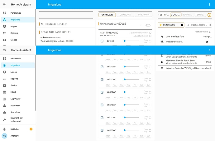

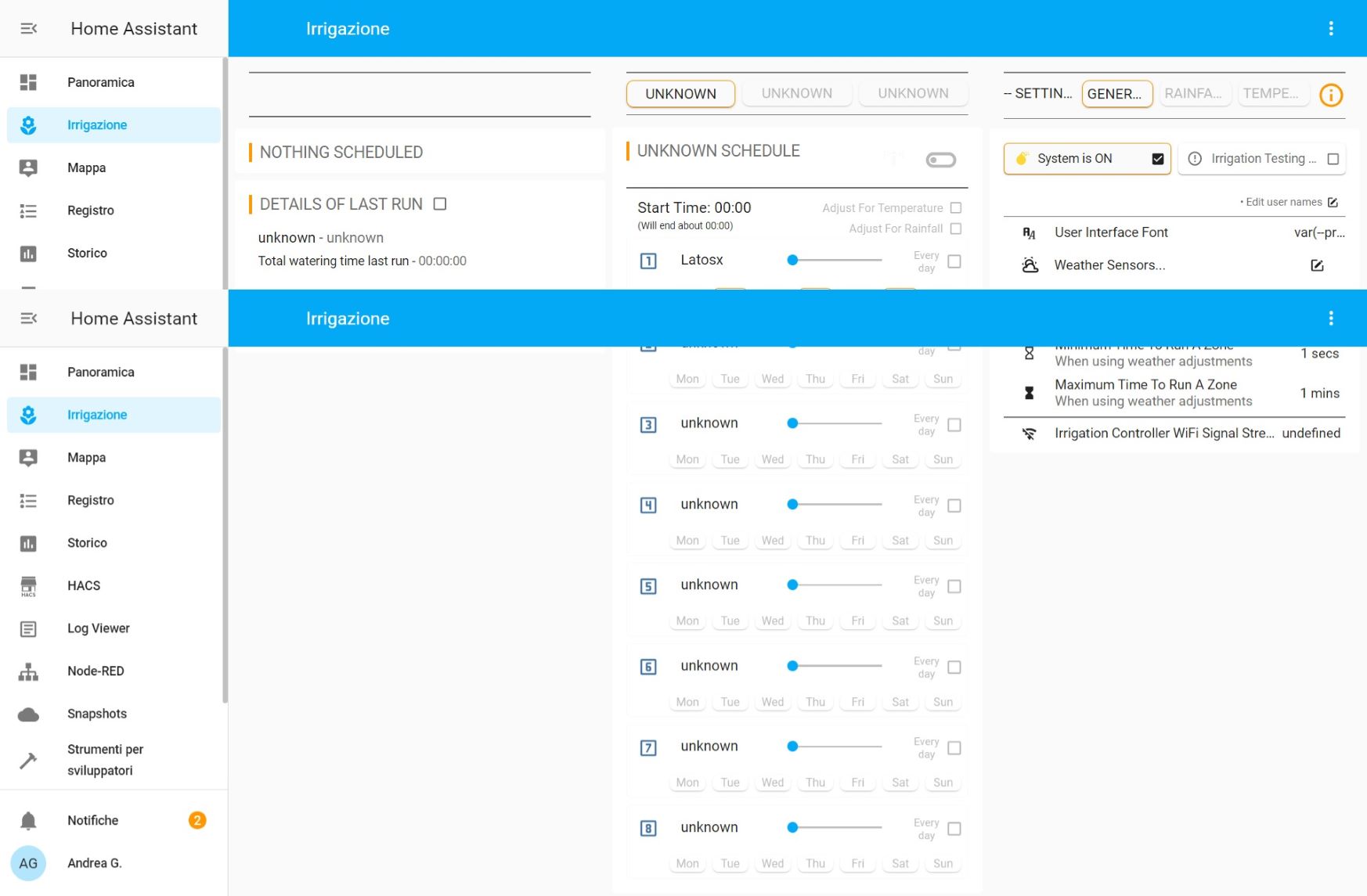

I am having problem with morning evening and manual buttons name missing they show unknown instead . Check the photo .
Any idea?
Also I have 12 solenoid valves in my garden if I understand correctly I can bind only one switch for every zone , so 8 is the max number of valves supported?
I cannot solve the problem with the given information as well.
But I can confirm, that the italian instructions are working fine on an up-to-date lovelace UI setup.
I had the same problem clearing the broswer cache solved it
Just click on [unknown] in the header [unknown schedule] and change the name to [morning].

I naively deleted the the lovelace and packages folder and changed with the ones coming from the fork but nothing is changed. Can someone help me changing version so I could use more than 8 sprinklers?

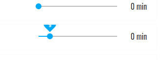

3)when I move the slider of irrigation time the number on the cursor is only partially visible
arrow

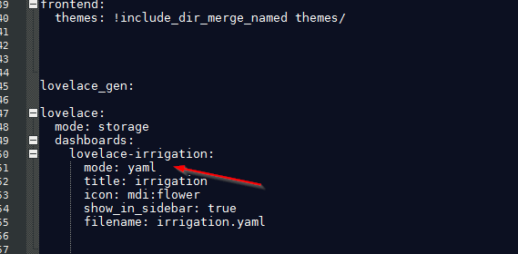

1.clearing the browser cache did not work…
2. lovelace-irrigation is in yaml mode.
