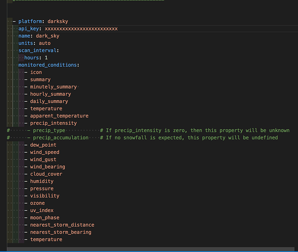

Here is my dark sky config which works, have a go with this below…
Hello everybody
can nobody really help me?
