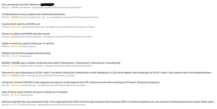

Settings > System > Logs
would be A good start.
But have a look at long term "history" data (E.g. the last month) to see if it is happening at regular times?
My first guess is that your "Supervisor" is crashing for some reason. so you need to find the time/s it is happening & have a look at what is logged under "supervisor"
You may need to alter your log settings

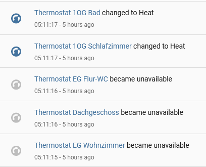

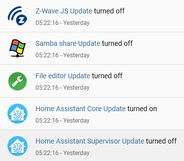

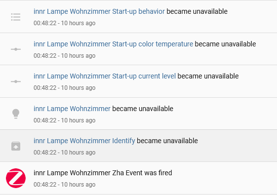

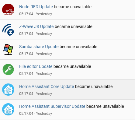

So I looked in the logs and can’t find much that immidiately jumps out as an error
when I look into the logbook from midnight to this morning, here are some interesting events:
so at 02:04 a light bulb became unavailable, then at 05:17 some update entites became unavailable and came back on at 05:22 and at 08:21 almost all my entities became unavailable (it’s a big log) and came back 20 seconds later. Not all though, my room thermostates still didn’t report and data and I had to restart HA to get them back.
Here are some System->Logs. This was after I restarted HA… is there any way to let HA also load older log entries?

    sock = await self._connect_sock(
  File "/usr/local/lib/python3.10/asyncio/base_events.py", line 960, in _connect_sock
    await self.sock_connect(sock, address)
  File "/usr/local/lib/python3.10/asyncio/selector_events.py", line 500, in sock_connect
    return await fut
  File "/usr/local/lib/python3.10/asyncio/selector_events.py", line 535, in _sock_connect_cb
    raise OSError(err, f'Connect call failed {address}')
ConnectionResetError: [Errno 104] Connect call failed ('192.168.1.53', 6668)
2022-12-28 05:29:40.019 ERROR (MainThread) [homeassistant.components.hassio.handler] Timeout on /host/info request
2022-12-28 05:30:45.104 ERROR (MainThread) [homeassistant.components.hassio.handler] Timeout on /core/info request
2022-12-28 05:30:45.106 ERROR (MainThread) [homeassistant.components.hassio.handler] Timeout on /supervisor/info request
2022-12-28 05:30:45.110 ERROR (MainThread) [homeassistant.components.hassio.handler] Timeout on /os/info request
2022-12-28 05:30:45.112 ERROR (MainThread) [homeassistant.components.hassio.handler] Timeout on /store request
2022-12-28 05:34:03.729 ERROR (MainThread) [homeassistant] Error doing job: Task exception was never retrieved
  File "/usr/local/lib/python3.10/site-packages/aiohttp/http_websocket.py", line 676, in ping
    await self._send_frame(message, WSMsgType.PING)
  File "/usr/local/lib/python3.10/site-packages/aiohttp/http_websocket.py", line 653, in _send_frame
    self._write(header + message)
  File "/usr/local/lib/python3.10/site-packages/aiohttp/http_websocket.py", line 663, in _write
    raise ConnectionResetError("Cannot write to closing transport")
ConnectionResetError: Cannot write to closing transport
2022-12-28 05:35:42.649 WARNING (SyncWorker_0) [homeassistant.loader] We found a custom integration scheduler which has not been tested by Home Assistant. This component might cause stability problems, be sure to disable it if you experience issues with Home Assistant
2022-12-28 05:35:42.663 WARNING (SyncWorker_0) [homeassistant.loader] We found a custom integration adaptive_lighting which has not been tested by Home Assistant. This component might cause stability problems, be sure to disable it if you experience issues with Home Assistant
2022-12-28 05:35:42.685 WARNING (SyncWorker_0) [homeassistant.loader] We found a custom integration localtuya which has not been tested by Home Assistant. This component might cause stability problems, be sure to disable it if you experience issues with Home Assistant
2022-12-28 05:35:42.693 WARNING (SyncWorker_0) [homeassistant.loader] We found a custom integration hacs which has not been tested by Home Assistant. This component might cause stability problems, be sure to disable it if you experience issues with Home Assistant
2022-12-28 05:35:42.701 WARNING (SyncWorker_0) [homeassistant.loader] We found a custom integration dahua which has not been tested by Home Assistant. This component might cause stability problems, be sure to disable it if you experience issues with Home Assistant
2022-12-28 05:35:42.708 WARNING (SyncWorker_0) [homeassistant.loader] We found a custom integration nodered which has not been tested by Home Assistant. This component might cause stability problems, be sure to disable it if you experience issues with Home Assistant
2022-12-28 05:35:42.718 WARNING (SyncWorker_0) [homeassistant.loader] We found a custom integration eufy_vacuum which has not been tested by Home Assistant. This component might cause stability problems, be sure to disable it if you experience issues with Home Assistant
2022-12-28 05:35:42.732 WARNING (SyncWorker_0) [homeassistant.loader] We found a custom integration thermal_comfort which has not been tested by Home Assistant. This component might cause stability problems, be sure to disable it if you experience issues with Home Assistant
What time is sunrise? Because you have something happening at about 5am that is recurring. You may need to start uninstalling thing to find it.
But it looks like you aren’t running the latest version of HAss try updating, first…
