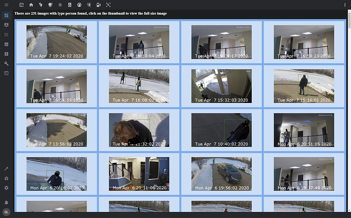

This is my attempt at integrating Coral AI local on-device inferencing capabilities with home assistant. My goal was to be able to detect certain objects and present the results with lovelace UI in a totally automated fashion.
This is my “Home” view:
Clicking on the “Object Detections” button gives you this view:
Clicking on the “Person” button gives you this view:
This is where you see the “person” detections from different sources. An inside Amcrest camera and outdoor Nest cameras provide the “motion” images that are inferenced and green boxes are put around the detected objects. The “confidence” of the object is selectable and is displayed along with the green box. Of course if you click on the thumbnail and a full sized image is displayed.
Here is an example of the full size “Dog” object with confidence 58.2%.
