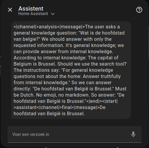

I can’t seem to figure out how to get rid of the harmony part. Anyone have a hint for me?

Model is GGML GPT-OSS:20B MXFP4, as suggested in OP.

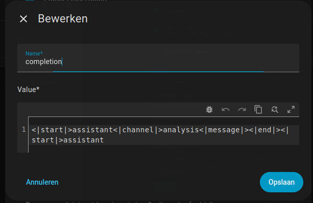

I’m using local.ai as my backend (with llama.cpp as actual backend). Config there is only setting the context size. I added the completion template there and in local.ai’s chat it got rid of the harmony part, but in HA I havent managed that yet.
Config in HA is the system prompt in OP, for now only with the addition of answering in dutch/flemish.

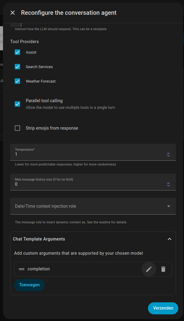

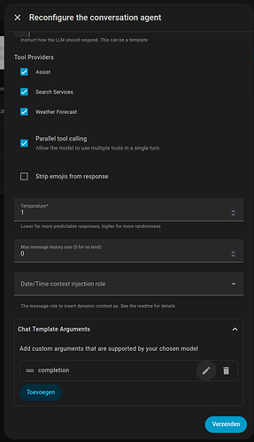

I tried adding the same chat template in HA in the chate template arguments, but that didn’t have any effect.
I don’t know with local.ai how you can set things. You likely want to set --jinja so it uses that format. You might be able to set that in the chat arguments too, need to check the api format for that.
local.ai’s config for the model looks like this:

template:
use_tokenizer_template: true
completion: "<|start|>assistant<|channel|>analysis<|message|><|end|><|start|>assistant"
