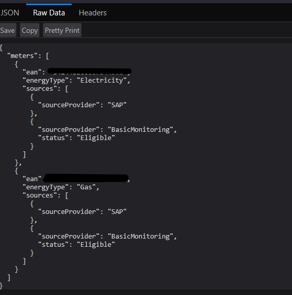

ok, It looks like you’re logged in succesfully but the Luminus API is returning different information with your account. Do you have multiple meters (Gas, Electric, multiple ean numbers)?
Can you send me an anonymized response from the API call? Just use your browser, login to my luminus, then paste the url (https://www.luminus.be/myluminus/api/meter-readings/available-sources). You should see a JSON response wirth all your EAN meters.
Yes, I have multiple ean-numbers, electriciteit and gas.
The response is exactly the same as yours, although not in one screen. When I log in it’s already either electriciteit or gas.
hmm. ok, so you get the same response in your browser while the integration receives a 500 internal server error. I created this integration by reverse engineering the MyLuminus website. It is possible that I’m missing some mandatory requests for your account.
Unfortunately, I cannot reproduce this error on my account. This makes it difficult to debug and fix. When you log in with a browser, do you immediately see your dashboard with gas and electricity graphs? Or do you use multiple Luminus accounts within one login?
The failing API call is used to determine the EAN numbers and the type of meter (Gas/Electricity). Perhaps I could add a feature to manually add the EAN and type.
The actual price information is retrieved from this API call https://www.luminus.be/myluminus/api/price-information/{ean}. Where {ean} is the EAN number of your meter.
