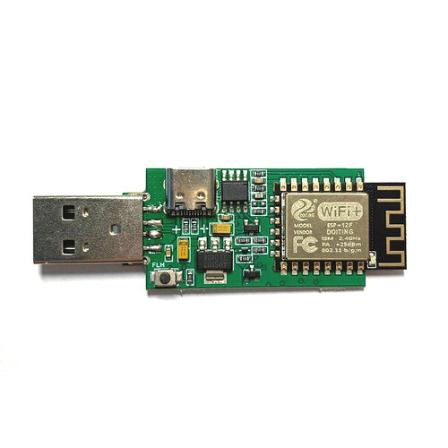

Eww… yall are still using the provided Midea comms? Gross.
Get this 3rd party dongle. It plugs into the Midea AC unit and controls it. It shows up in HA as a standard AC unit and doesn’t give any fuss.
It’s literally the easiest alteration you can make for a Midea thingy.
