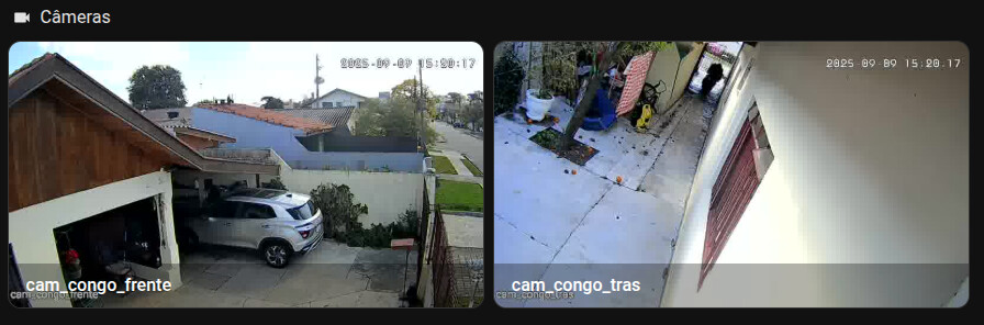

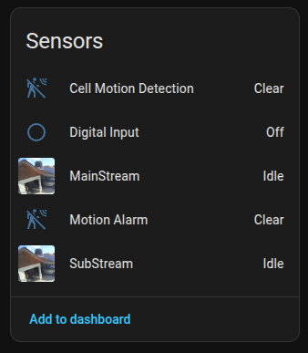

new update people!
in the new versions of HAOS, the ONVIF integrations is better.
if you have any camera (in my case the ICsee one) that provider ONVIF connection it is plug and play… just like that…
You only need to check if the camera’s onvif connective is active… and if the camera is in the same networkt that HAOS. knowing the camera’s IP you only need to select the autodetected camera in the ONVIF home assistant integration, it will ask for a entity name, user and password(in my case ICsee app camera user and password, that I can check in the ICsee app ‘camera info’), set it up and click add… all entitys are discovered automaticly! AMAZING!
ps.: you need to configure PTZ manualy via .yaml, but that is ok.
ps.: you enable substream and watch in real time in the dashboard.
My setup resume:
my os: Linux Ubuntu
camera: ICsee (360º PTZ)
quantity: 2 cameras
OS: HAOS (local and nabukasa)
integration: ONVIF
dashboard component: picture glance
HAOS manualy configuration: NONE
plug and play: YES
