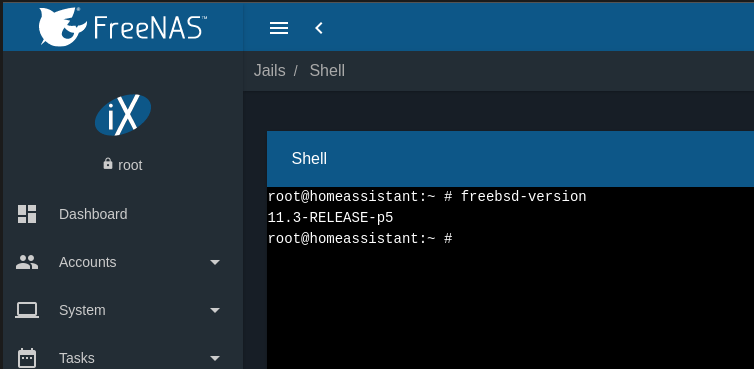

I reinstalled FreeNAS 11.2-U7 in a VM to test it out and everything seems to ok. I only notice one weird discrepancy in the HA dev panel it shows as running 11.2
But at the console I can verify this is infact using 11.3
That does not seem very serious but I think it proves it is not perfect when using 11.3 plugins on FreeNAS 11.2 host

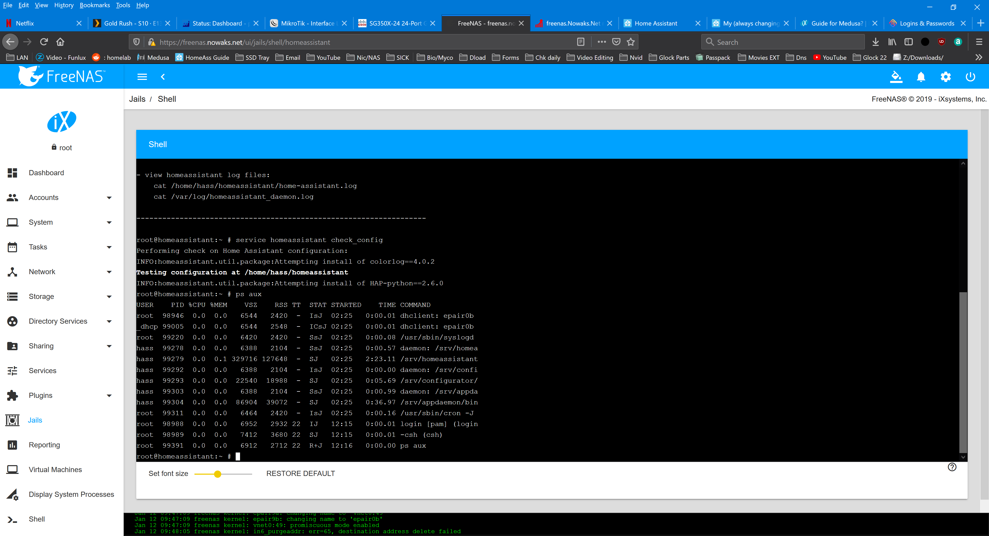

configurator works now, I did a new install for reasons. Now app daemon & HA dash will not load config is correct . I try to start app daemon in HomAssi it says its starting, so when I do status appdaemon is not running. I made sure it was installed. Not sure what to do it has done this to me on 2 install’s
I just figured out appdaemon 4.0.0 is released. We need some extra options in the configuration file. I’m working to update my github now. No need to wait for me though
In general for troubleshooting, you can check the daemon logs. These output what you would see if you started the application straight from the console. They are located inside the jail in /var/log/SERVICE_deamon.log Where SERVICE is appdaemon or homeassistant ect.

appdaemon is still not running. even If I manually start it. I reloaded Every thing to see if it was a HomAssi problem.

what’s the output from
tail -n50 /var/log/appdaemon_daemon.log
