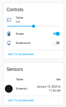

I see a ton of issues with the FK integration all of a sudden. I actually deleted all of the devices and then added my tablet back. No issues going through that, but I’m missing my battery sensor, which means my charging scheme will no longer work:
What’s going on with this integration?

Yeah, battery level shows in the FK admin page… so it’s definitely a recent integration problem. I’ve deleted and reinstalled a few times. No luck.
