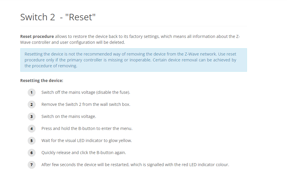

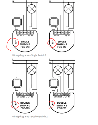

I had the eedomus controller and it’s broken. I had like 10 fibaro switches connected to it and i need to reset them. Models FGS-222 v2.2 [relay switch] and FGS-223 v3.2 [double switch].
How I can reset the fibar switches connection and configuration to connect them into a new z-wave controller?
Do I have to connect the switch to electricity or not?
How do I connect the switch to electricity to do this?
Do I need a new zwave controller to do it?
