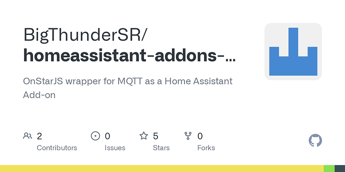

Im working on an addon booting the MichealWood code as a docker image compatible with home assistant, if I can get it to work I will post it here
Just a quick update, I have been able to load the docker with success as an add-on. Im now making the config to be home assistant friendly, and try to load password thought the !secrets.
Just realize I never update the thread,
turns out somebody already done it so I did not hat to continue developping it
Thanks for doing this. I have installed this and is running without error but I do not see any sensors created. Should there be any sensors or is just to issue commands?
It does create this one mqtt sensor:
homeassistant/VIN/available
thanks!
