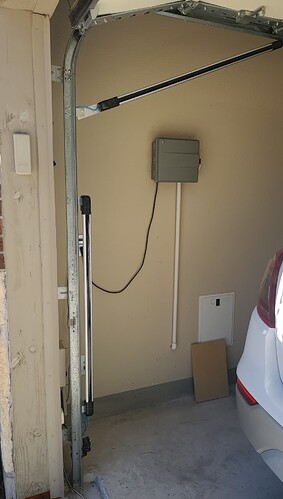

I built an ESPHome device that controls 2 IR curtains that detect obstructions where people/cars would be and lift gates up high if open. The system also disconnects the lower sensor as a way to disable the closure of the door. I also have a reed relay bolted to the ground that detects whether the door is open or closed. The way this is built, if you power it down or disconnect any any of the IR curtains, the garage door keeps working.
