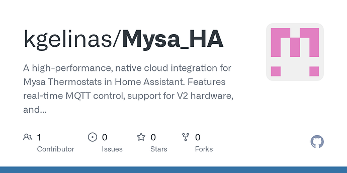

hey just found this topic yesterday and mysotherm repo that this is based.
I’ve put out this quickly as a first draft for an extension that use mysotherm to get and set state for Mysa natively (without homekit)
again this is a rough draft (created with Google antigravity and gemini so your mileage may vary :smiley: ) that work with my Baseboard v2
I tought this could come handy for some here
Had to fix some library code from mysotherm mainly for dependencies
It’s working for now haven’t even look at the code done by gemini
Here it is

Also @Kgelinas I tried your version and found a couple of issues
  • it doesn’t support half degrees in C. If I adjust the setting to a half degree using your integration in HA, it only updates to the int value
  • it doesn’t respond to settings made elsewhere. I tried changing the setting using HA homekit, HA mqtt and the native app but none caused yours to update.
That’s amazing work! Just installed it and its working like a charm. I am willing to test any beta / features that would be useful on your end, I love my mysa thermostats and am so happy to see such an extensive integration developped. Cheers
I’ve been busy updating it and fixing a lot of issues
If you still want to give it a go feel free to give me some feedback
