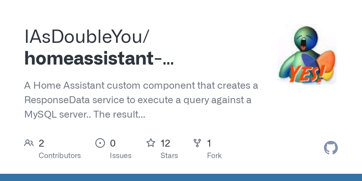

MySQL Query
A Home Assistant custom component that creates a ResponseData service to execute a query against a MySQL database. The result values become available as an iterable data structure

**Note for upgraders:** Please check the [README on GitHub](https://github.com/IAsDoubleYou/homeassistant-mysql_query) for the updated service structures and the full list of return fields.
Check it out here: IAsDoubleYou/homeassistant-mysql_query
