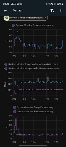

I saw that my CPU, RAM and temperature as well as network usage spike up around the time of the problem, like this:

Check the HASS logbook for anytthing happening at 01:00:10 as that sounds like a daily scheduled systemd / cron job.
The other test is to power cycle everything and see if the issue moves in time - MQTT data can time-out (depending on retained and availability settings).

I also suspect that, however Iām not the network administrator nor do I have access to the networking equipment, I just have an Ethernet port in my room where my HA and my PC get their Internet connection from.
How could I check if it really is a scheduled reboot of something?
