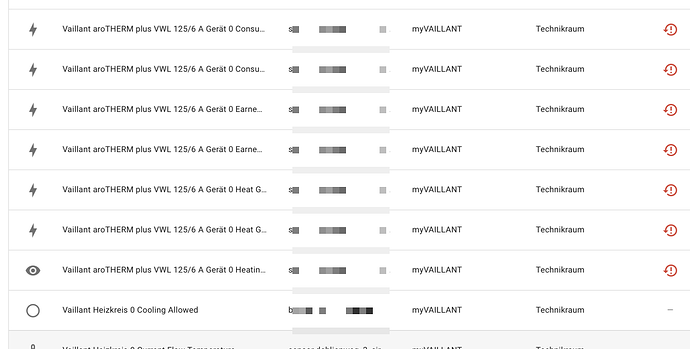

Hello, does anybody know why the consumed energy of my Vaillant heat pump is not provided anymore? It was provided until a week ago…

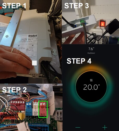

Working Setup:
Vaillant auroCOMPACT VSC S 206/4-5
Vaillant VR940f (80 Euro)
Note: Any changes at your own risk! Damage can cost thousands to repair! I’m doing this based on electrical experience - the mod is in summary very simple - just attaching 2 wires to the BUS connector. Make sure to get +/- the correct way around!
This cost me under 80 EUR and about 15 minutes. Much less than paying ~1000 EUR someone originally quoted me for a smart boiler upgrade in Germany!
Carefully remove the front cover panel and then the 4 screws. The control unit now just folds down and is attached on the top via a magnet. Put a box or something underneath to protect the control unit scratching / folding too far forward.
STEP 1
Open the clips to access the PCB underneath. Be careful not to cause any shorts! Connect a suitable 2 cable wire through with good terminations (I used bootlace crimps), and nicely route. In my case I could easy push the cable through to the back of the boiler as other cables followed that path. Ensure +/- correct way around! written on the connector. Close up the clips and everything nicely.
STEP2
The VR940f comes with a green 2 pin connector and white power cable, that white 4 pin cable is not needed - you disconnect from the 2 pin connector BUT NOTE FIRST! The red is in +ve, and black is in -ve, take a photo to remember - you need to ensure your connector + goes where the red wire was, and the - goes where the black wire was.
The VR940f comes with a 5V supply that plugs into the power.
STEP 3
Install the myVALLIANT app. Ignore the video showing how to connect it if your boiler is an auroCOMPACT it’s not as in the app video but as in the pictures shown here.
STEP 4
I used my ssh to git clone GitHub - signalkraft/mypyllant-component: Home Assistant component for the myVAILLANT API, controls Vaillant devices such as aroTHERM heatpumps and ecoTEC boilers, into /tmp/ on my Raspi 4B, and then I did cp -a mypyllant-component/custom_components/mypyllant /config/custom_components/
Then Restarted Home Assistant, and added the myVALLIANT integration. BOOM the entities are now available.
Finally setup a nice Home Assistant Dashboard!
Thank you everyone!

Since the core update to 2025.1.0 I have problems loading the integration. I can find the following log lines:
“2025-01-04 11:14:30.336 ERROR (SyncWorker_0) [homeassistant.util.package] Unable to install package myPyllant==0.8.36: Ã No solution found when resolving dependencies:
â°ââ¶ Because mypyllant==0.8.36 depends on pydantic<1.11.0 and
pydantic==2.10.4, we can conclude that mypyllant==0.8.36 cannot be used.
And because you require mypyllant==0.8.36, we can conclude that your
requirements are unsatisfiable.”
