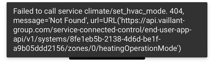

HI!
I run the integration for several weeks and everything worked nice.
Since yesterday, any actions are answered with an error: Fehler beim Aufrufen des Dienstes… 404 message:Not found
Any Ideas?
Same here. Error 404

Luckily it appears to still be working for me. So, maybe some kind of local server outage or something?
Vaillant changed their API endpoints again, there’s a new beta release that should fix it.

Following a power outage to the whole house I now have 3 more entities so the controls now appear for the integration. The problem is however that they do not work :man_facepalming:t2:
@dcw77 try the latest beta release please, Vaillant recently changed the APIs again for these controls.
