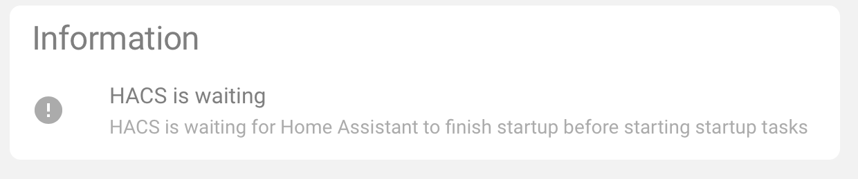

Mine is still stuck waiting cloud process to start since one hour, preventing HACS to finish starting.
Well, system is back. All good. But the issue is still valid and a huge problem. Inability to access the Home Assistance Cloud should not adversely affect the rest of the HA system. I’m on the trial of Nabu Casa, so I will try to see if the same behavior occurs when setting up my own Alexa integration.

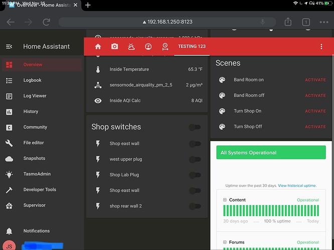

The Alexa integration (actually this should be universal) should also check Status of the AWS cloud and warn the user so we don’t spend hours thinking something else is wrong. I’ve done this at least 3 times now. For those that don’t know, The service status URL is
https://status.home-assistant.io/
Thanks to @123 Taras for that! I’ve been on Nabu Casa for several months now and it works ā€œmostā€ of the time!
Is there a cloud status Lovelace card/integration that I don’t know about that could help here? If not, there should be… other than just embedding that webpage in a card.
