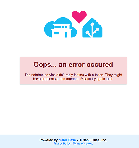

Sadly after uninstalling I get the following when trying to reinstall
Anyone recognizes this? Just a matter of trying again later? Or is something wrong with the Nabu Cas Account Link functionality?
Not sure if it matters, but instead of installing the integration from within HA, I tried using the ‘Add Integration’ button from Netatmo - Home Assistant and now everything is running again
