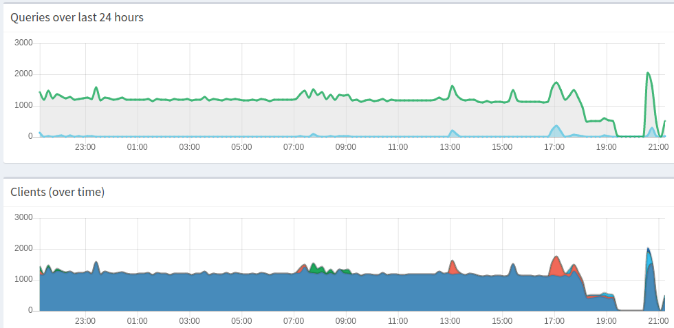

I’m getting the same thing, 4 hours ago HassIO supervisor updated itself automatically. Looking at my PiHole setup I’m now no longer seeing DNS requests from my HassIO IP address, and I also have a new docker container:
hassio > login
# docker ps
CONTAINER ID        IMAGE                                             COMMAND                  CREATED             STATUS              PORTS               NAMES
03cscsq65836        homeassistant/armhf-hassio-dns:1                  "coredns -conf /conf…"   4 hours ago         Up 4 hours                              hassio_dns
e8e86ee6c0b6        homeassistant/armhf-hassio-supervisor             "/bin/entry.sh pytho…"   4 hours ago         Up 4 hours                              hassos_supervisor
4a6780ee51c8        homeassistant/raspberrypi3-homeassistant:0.97.2   "/bin/entry.sh pytho…"   4 days ago          Up 3 hours                              homeassistant
docker exec homeassistant ping www.myblockeddomain.com
PING www.myblockeddomain.com (12.66.1.6): 56 data bytes
Also I’m now able to access www.myblockeddomain.com (example) from HA despite me blacklisting it in PiHole. Here’s my pihole graph:
Blue block was my HassIO IP. :frowning: I’ve tried your hassio dns info command and I get this error:

Edit : same graph, pi-hole not used by hassio anymore :

I’ve corrected my DNS server, and rebooted the entire HassIO machine, and it seems to be using my PiHole DNS again now.
