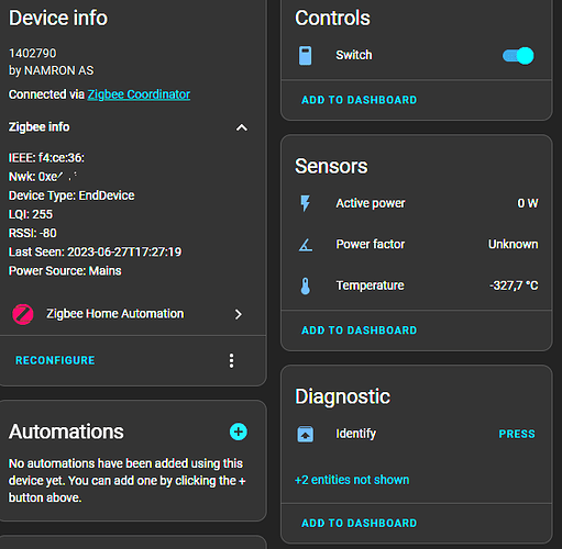

The zigbee functionality in this the device is described at page 9 in this [link](https://www.elektroimportoren.no/docs/lib/1402793-Brukerveiledning-5.pdf)
I have started to create a converter, but hit the wall
In Z2M, it looks like this:
The temperature varies. Often down to -300 C.
The link quality does seem way to low.
And the logs say the battery reports status every 5 seconds, which I would think is totally unnecessary.
Help is appreciated
