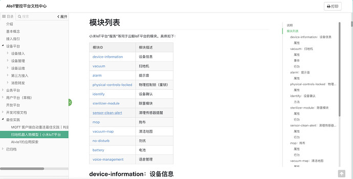

In the China region, you can first connect to Mi Home and then integrate it into Home Assistant through the Xiaomi Miot Auto integration. Although the official API documentation lists many properties and events, I can only retrieve a small portion of them - most properties either appear non-existent or are shown as unknown attributes.
Official Technical Documentation:扫地机器人物模型丨小米IoT平台
