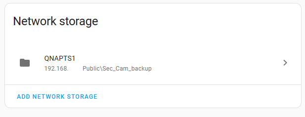

I’m using the “Samba share” addon from the addon store. The folder is mapped in Network Storage
On my QNAP the shared folder is on the HDD named DataVol2. The folder is called Media. It has a user and password enabled. R/W allowed. The path that QNAP displays is /Media. The user is enabled in the QNAP users list. Is that all good on that end? I installed Samba share.

When setting up the network storage in HA you will put that info here.
