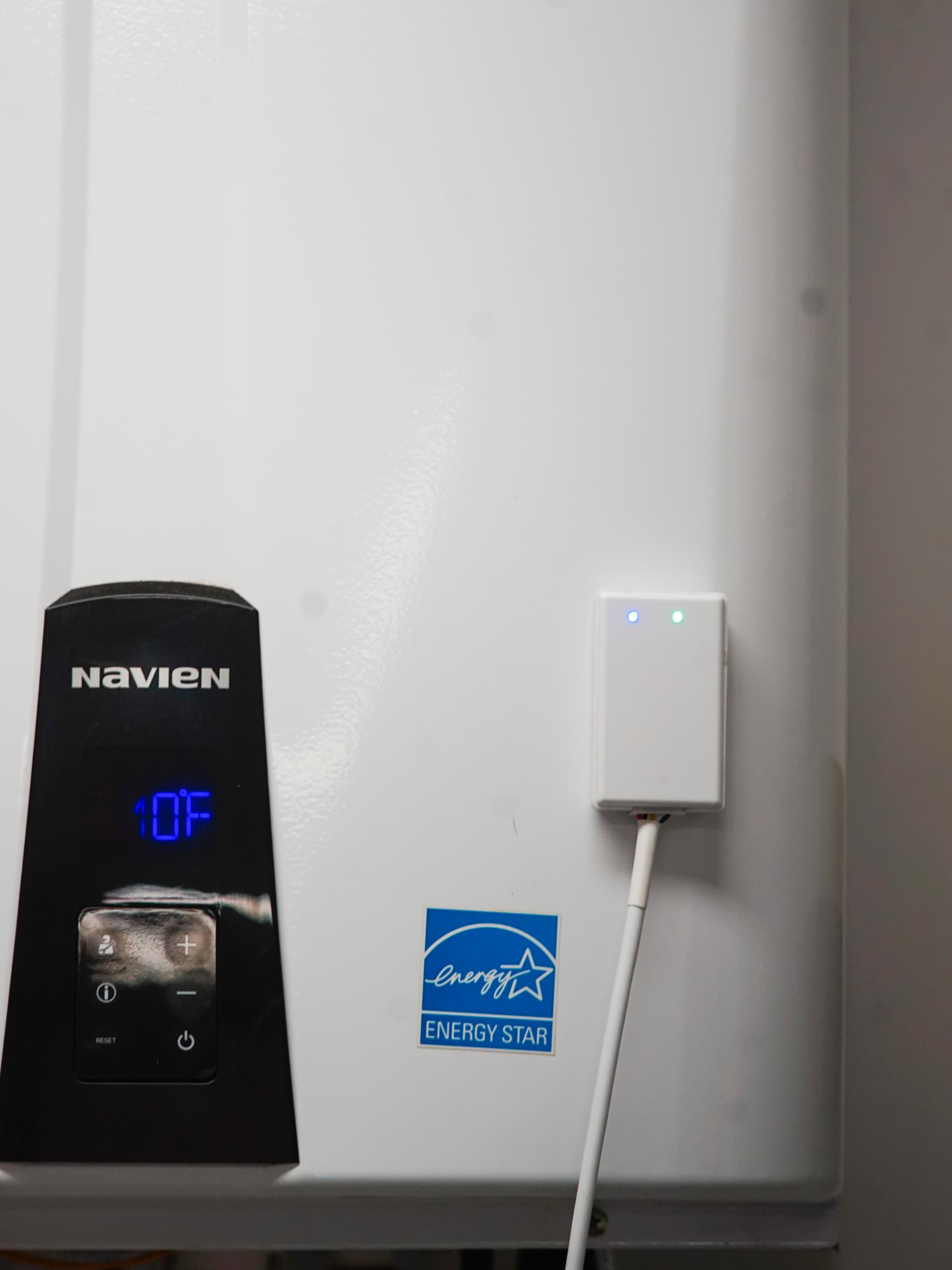

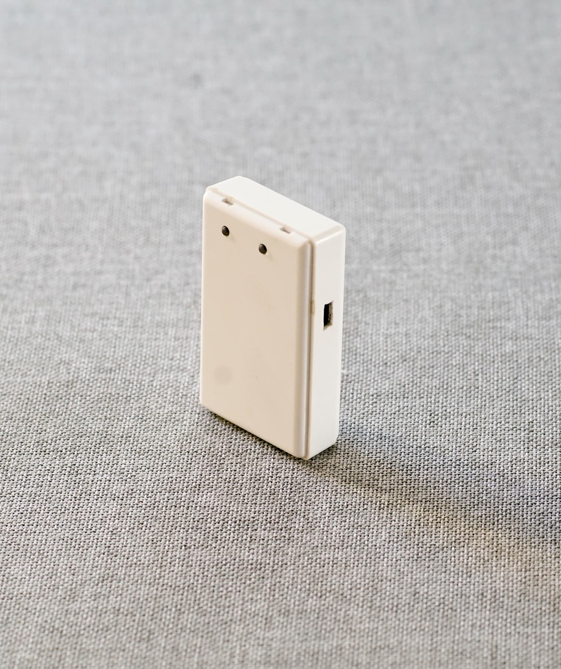

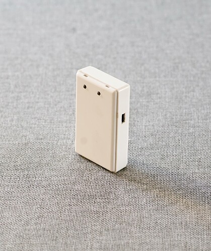

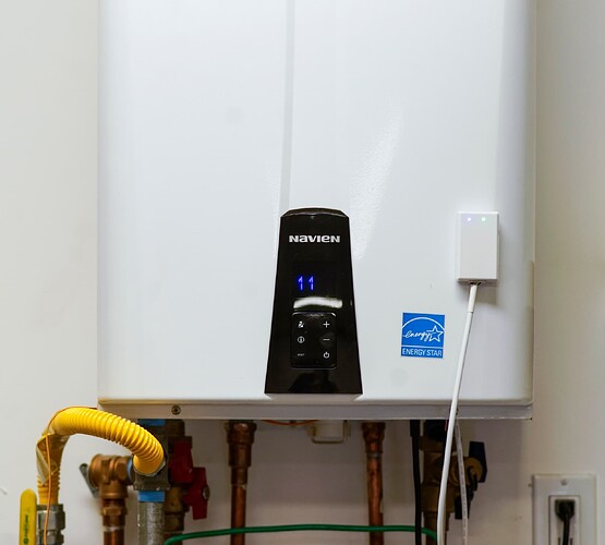

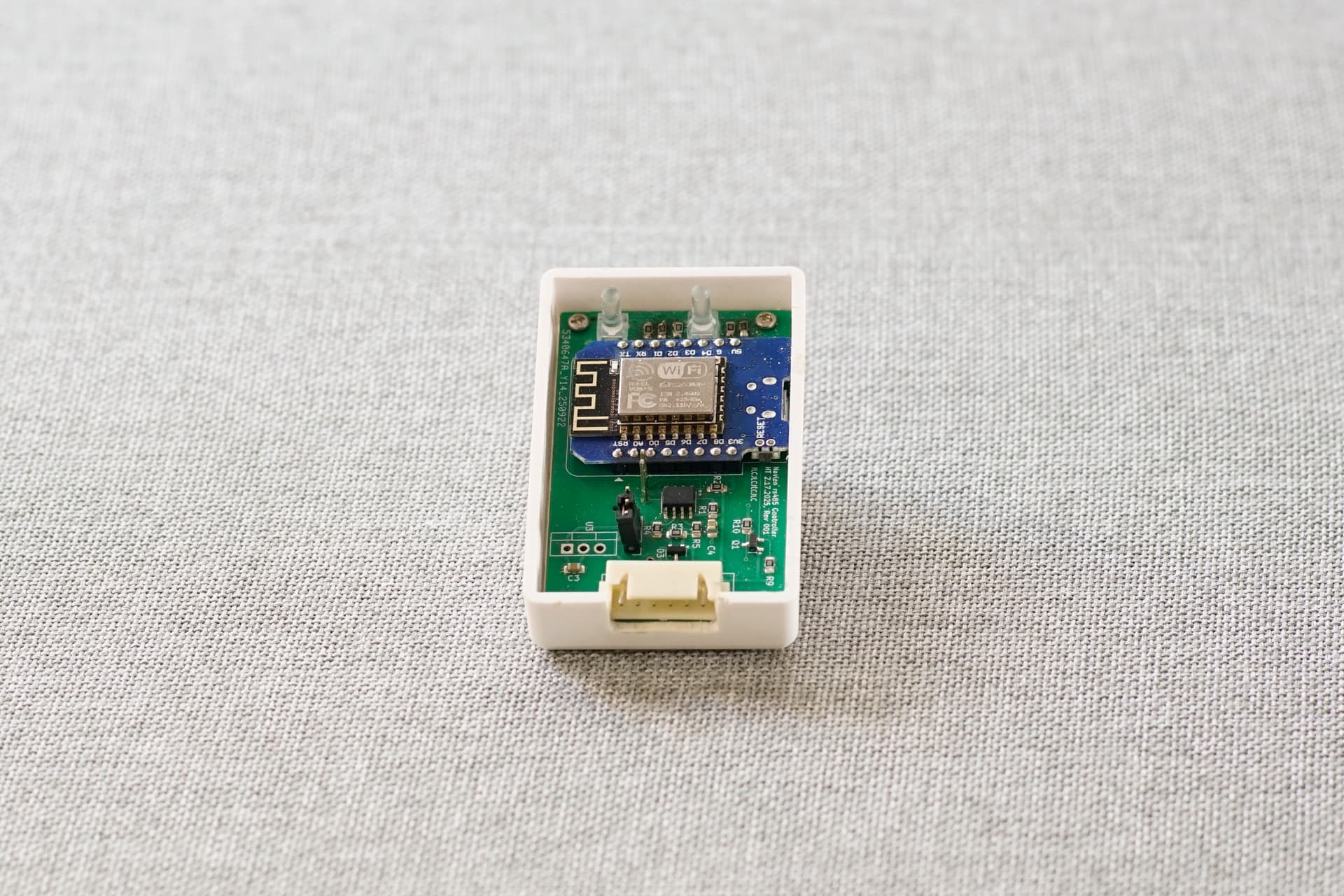

Here is how the device looks like. It has two leds indicating the status of Wi-Fi connection and the RS485 to Navien.

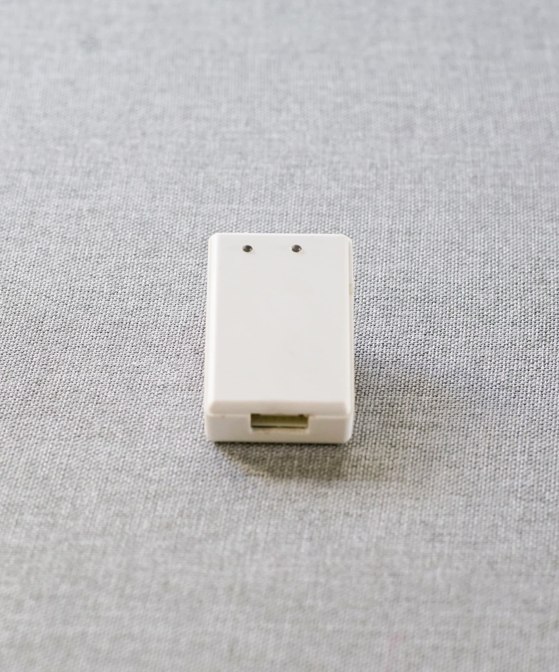

It comes with a custom wiring harness for plug-and-play connectivity to Navien-240a. It can be modified for other Navien models also.
It can work off of a USB charging brick connected over micro-usb connector on the side or fed from the Navien-240a internal power supply (I like the latter to avoid extra wires). The micro-usb connector can be also used for flashing the new versions (of course, the normal esphome ota works too).
