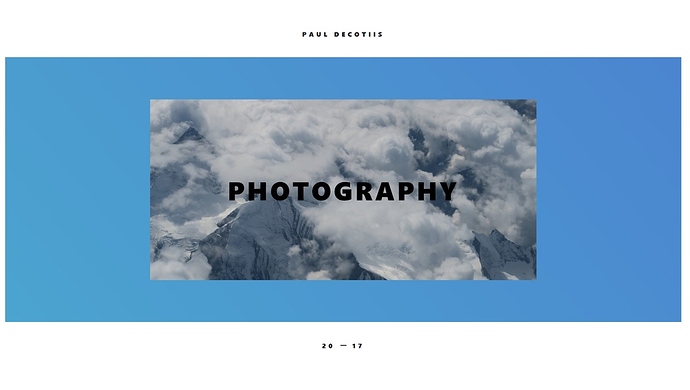

googling for “css page transitions” brings me for example to this page:
