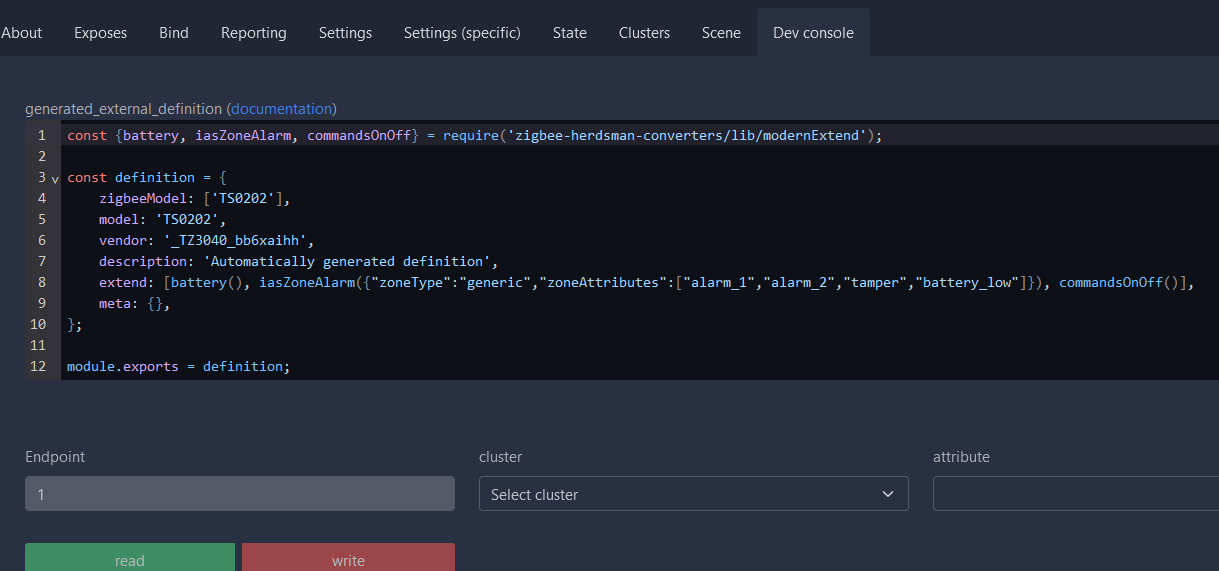

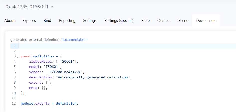

Well, are you sure the fingerprint matches yours?
What does yours say?

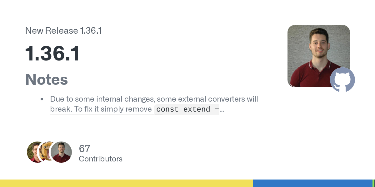

Thanks for the reply, I dug a bit further and found this in the logs:
[2024-11-18 14:26:36] error: z2m: Failed to load external converter file ‘ZBHTR20WT.js’ (Cannot find module ‘zigbee-herdsman-converters/lib/extend’
I am currently running Z2MQTT 1.41.0-1
I’ve read something about z2m Edge version, but these posts are from 2022.
The generated file says this:
Just remove the line
Hah, that did the trick.
Thank you so much!

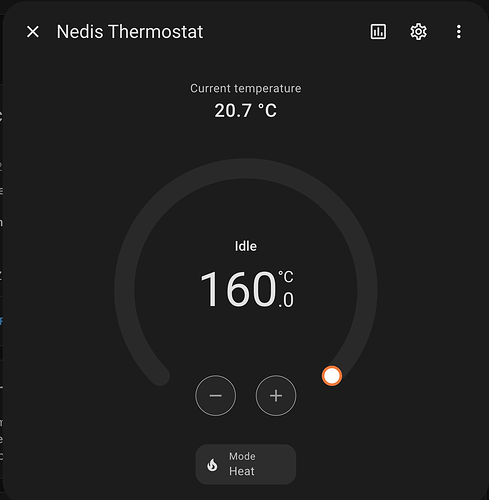

Has anyone turned that into a ZHA configuration/quirk? Otherwise I’ll look into it…
Sweet bananas! … and I immediately found a bug. :grin:
Can’t set the thermostat to a different temperature via UI. If you try, the set temperature jumps to 160C and the UI complains that it’s not a valid one.
That would be little hot. I don’t have issues, but dont use latest quirk yet, see below code in my quirk

I can compare versions later. I’ve deployed the official ZHA device handlers release 0.0.134.
You quirk helped to find the issue: It’s this:
-        Thermostat.AttributeDefs.abs_min_heat_setpoint_limit.id: 500,
-        Thermostat.AttributeDefs.abs_max_heat_setpoint_limit.id: 3000,
+        Thermostat.AttributeDefs.min_heat_setpoint_limit.id: 500,
+        Thermostat.AttributeDefs.max_heat_setpoint_limit.id: 3000,
I’ve replied to the issue. The abs attributes should be used for the constant attributes. So, the upstream quirk is correct in that regard.
If you were using custom quirks before, you may need to completely remove and re-pair the device to clear attribute cache, as the non-abs values may be cached. They should not be set by the quirk.
At least currently, I don’t see an issue with the quirk, but we’ll investigate further in the issue. Please attach device diagnostics there.
In general, custom quirks are only meant to be temporarily used for testing.
If you want to have the new upstream quirks, you should try the Home Assistant Core 2025.3.0 betas, as they include the latest ZHA library (with the latest zigpy and zha-quirks 0.0.134). The full HA 2025.3.0 version will release in about two days, but the betas are already pretty stable at this point.
I have no problem waiting for the full release. (I usually don’t upgrade to .0 releases but in this case I’ll make an exception :wink:)
It was a rather weird timely coincidence that I bought a full set of those TRVs a week ago, hoping that they would already be supported but apparently were just being added so I had a time constraint to either getting them (close) to working or sending them back to not miss the return window and ending up with expensive paper weights…
Nice, i had exactly the same timing for getting them work or sending it back :slight_smile:
glad i came quick to something working with all the efforts others already made
