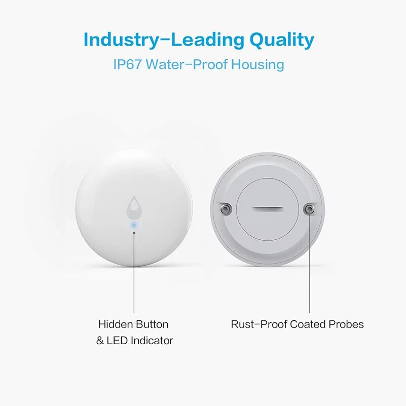

Alternatively, if you can’t be bothered to do any modifications, you can use a flood sensor. The probes on those are essentially dry contacts, and you can extend the probes on some models like the Aqara sensors without needing to open the device.
