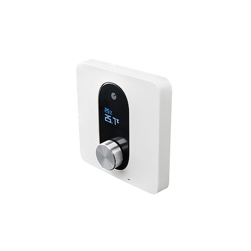

This is one example, pricey but it’s Shelly.
