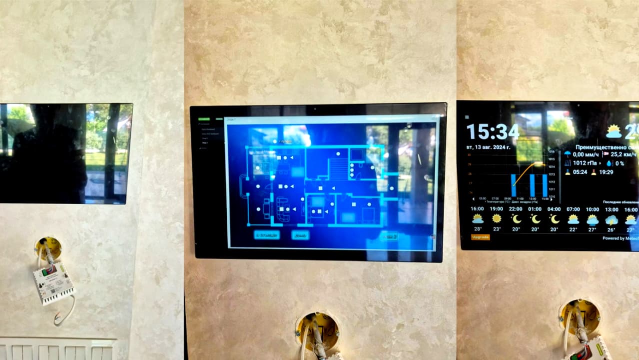

Hello, we are offering wall mounted tablet which is perfect for smart home control panel, here is some images that customer send us back.
@Fiona Can you tell which company offers this tablets?
