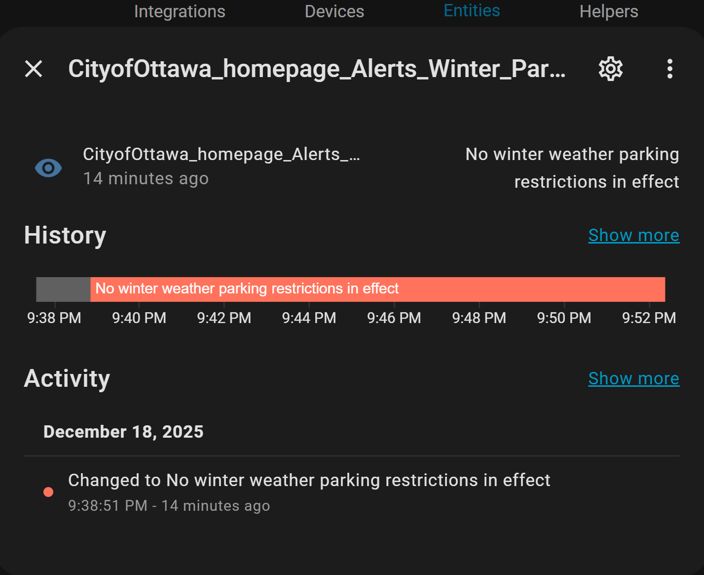

Sure. I had actually removed it after testing, but I readded it now to test again with the same positive results. Here’s the whole thing, a literal copy and paste of your config with the button.
multiscrape:
  - name: City of Ottawa
    resource: https://ottawa.ca/en/parking-roads-and-travel/parking/winter-parking/winter-weather-parking-bans
    scan_interval: 360
    sensor:
      - unique_id: CityofOttawa_homepage_Alerts_Winter_Parking
        select: "#block-mainpagecontent > article > div > div > div > div:nth-child(3) > div > div > div > div > div > div > div.col-xs-auto.layout__region.layout__region--second > a"
        value_template: "{{ value | trim }}"
    button:
      unique_id: test_ottawa_parking
      name: Test Ottawa Parking

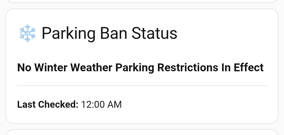

Dashboard…
type: markdown
content: >
  ### {{ states('sensor.winter_weather_parking_bans') | title }}
  **Last Checked:** {{ (states.sensor.winter_weather_parking_bans.last_updated |
  as_local).strftime('%I:%M %p') }}
title: ❄️ Parking Ban Status

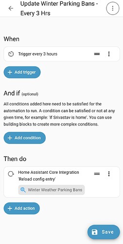

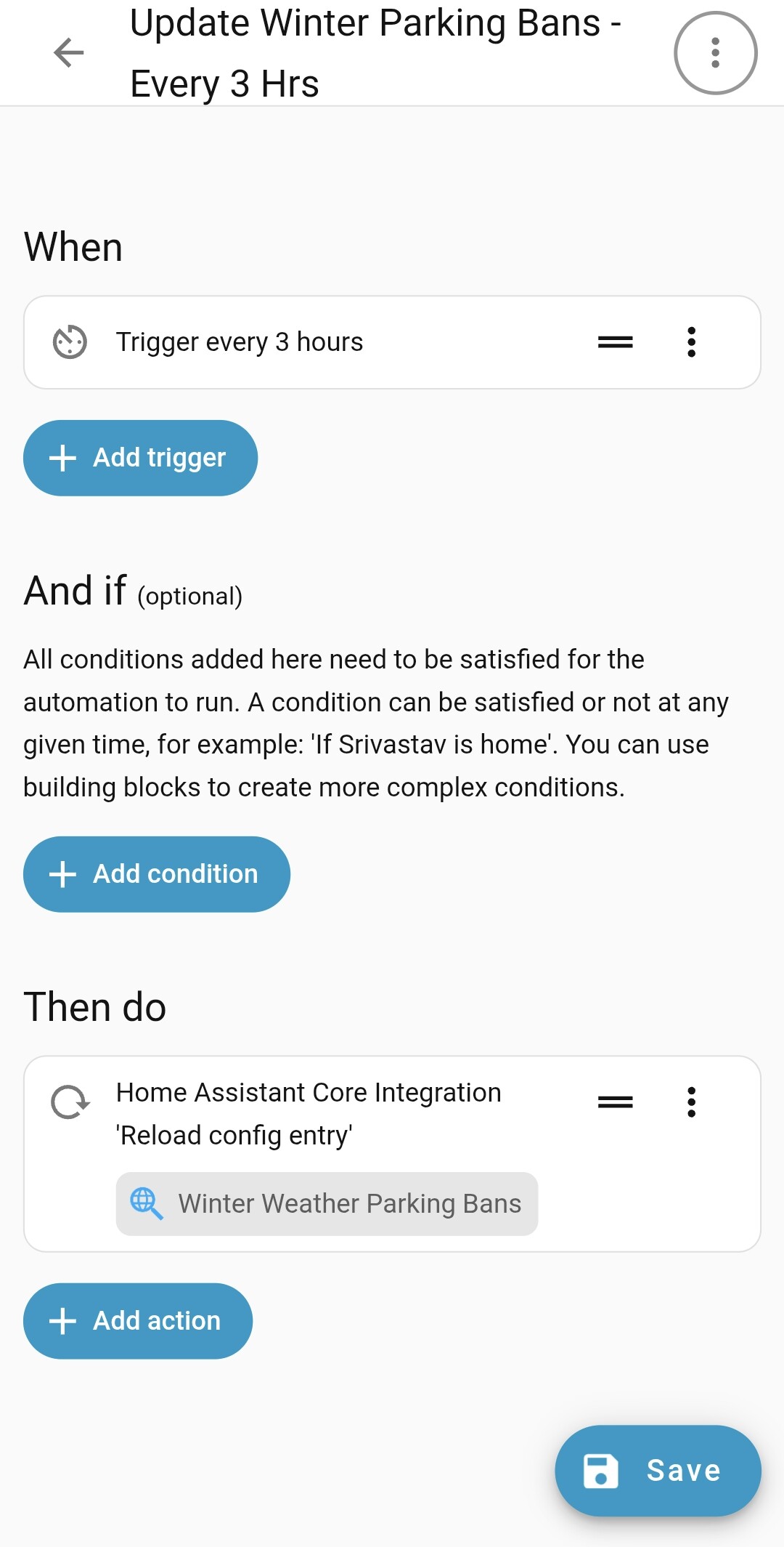

Automation…
