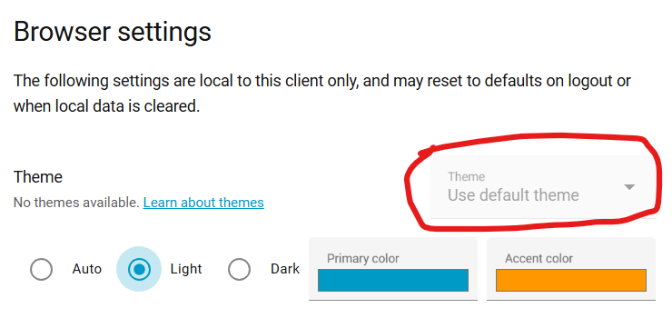

For some reason the “Use default theme” drop down is disabled:

Are there themes named “dark-theme” and “light-theme” in your themes directory?
IIRC, there’s a service created by Browser Mod that can switch between light and dark mode, but it’s been a while since I used that integration… so that may not be the case anymore.
Yeah there is no way to change the built-in theme light/dark mode automatically. This has been requested repeatedly since it was introduced many years ago - and so far ignored.
You need to define your own dark and light themes to do this.
I don’t have a themes directory. I guess I should create one and add the light-theme and dark-theme to it?
-Thanks
Oh! Thanks for the info. I presume I need to create my own dark and light themes and add them to a themes folder as Didgeridrew said.
-Thanks
Well, I installed the darkish and Google Light Themes, but this is still not working. Not sure what is preventing it from working. Using the toggle switch or running the actions directly has no effect.

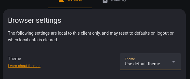

Have you double checked that the setting in your user profile is set to use the default theme? Also try setting the mode to Light.
Have you double checked the settings in the actual browser you are using? For me, using Firefox, it seems to work fine with any of the three settings, but that may not be the case with other browsers.
That was it! I didn’t have my default user profile set to use the default theme. Thanks again for all your help.
