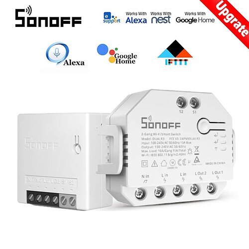

Maybe consider the Sonoff Dual R3 Mini R2:
Another option might be the Shelly 2.5, both of these assume that you have live and neutral available behind the switch.
