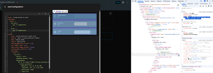

This image shows the gaps that are automatically added between cards in a section that I am trying to remove.
I’ve tried using card_mod to add styles directly to the card like shown below. I’ve tried attaching to ‘ha-card’, as well as ‘#root’ since that is the ID where these styles are coming from.

I’ve also tried applying these to a theme and using that theme to the dashboard this is in. (screen shot was taken before adding ‘row-gap: 0’ and ‘column-gap: 0’)

And through all of the ways to try and do this, I keep getting the same result where the vars aren’t found to set this gap (vertical-stack-card-gap, horizontal-stack-card-gap, stack-card-gap, row-gap, column-gap, gap), so then the ‘gap’ is defaulted to 8px.
I’m not sure where else to do. The closes thread to my question was this one which is what gave me the idea to try and use themes. I have been restarting my HA server (the quick load for reloading configurations) and been refreshing my page and clearing my browser’s cache between changes. I just can’t figure out how to override rules that are set on this root element. My end goal may not be for the ‘gap’ to be 0, but I’d like to figure out how to modify the properties here so I can control my layout more.

Here these need to be --vertical-stack-card-gap and --horizontal-stack-card-gap. Only when used in a theme do you omit -- as Home Assistant will put these in for you.
Easy to check in Browser tools (like your screenshot) that the variables e.g. --vertical-stack-card-gap are defined. If not then the theme is not applied correctly.
