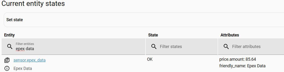

This is the sensor code with which I’m able to extract the first price. But how can i loop through the prices and build a comma separated list to store as an attribute?
sensor:
     - name: "Epex Data"
       value_template: "OK"
       json_attributes_path: "$.Publication_MarketDocument.TimeSeries.Period.Point[0]"
        json_attributes:
           - "price.amount"

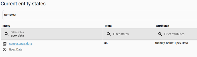

I believe you want this:
     - name: "Epex Data"
       json_attributes:
         - "Publication_MarketDocument.TimeSeries.Period.Point"
I’m a bit unsure about the indentations since your code is indented incorrectly but I guess this is correct.
And this should give you a list of the values

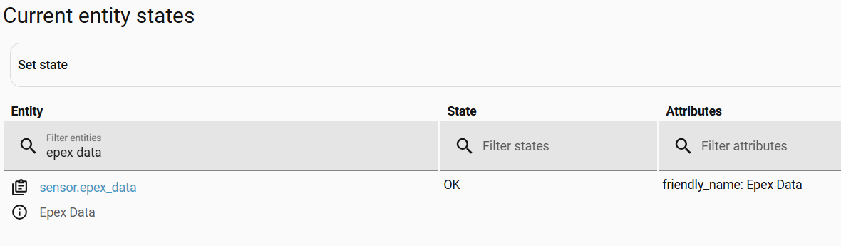

Anyway, I changed my rest sensor exactly as per your recommendation:
rest:
  - resource: https://web-api.tp.entsoe.eu/api?documentType=A44&processType=A01&in_Domain=10YBE----------2&out_Domain=10YBE----------2&periodStart=202510222200&periodEnd=202510232200&securityToken=xxxyyy
    sensor:
      - name: "Epex Data"
        json_attributes:
No error messages when the sensor is triggered, but I see no attributes appearing in the sensor state:
In the debug log file I see the xml data come in and the conversion to JSON, but after that nothing happens.
As for the list of prices that I would like to get in the sensor attribute: for me it doesn’t have to be comma separated, but that is what I see in some other implementations (e.g. Nordpool): numeric values separated by comma’s:
Do you see anything wrong?

I modified the setup of the rest sensor as per your recommedation:
rest:
    sensor:
      - name: "Epex Data"
        json_attributes:
          - "price.amount"
I get the first spot price as an attribute in sensor, which is the same as what I had before:
But what I want to achieve is the have a sensor attribute with a list of the 96 spot prices for the day that are in the JSON.
That is where I’m stuck…
Do you see a possibility?
