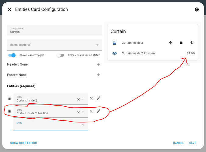

Thank you both for the assistance. Looks like this is working as expected. Now I need to learn how to make an automation to check after the command to raise or lower the curtain happens so that if there is a problem it will let me know.
One thing that I am noticing is that when the curtain is moving it will report either 0% or 100% (down 0%, and 100% up). Wondering if there is a way to either not report any change (just hold the previous value) or not report anything (null). Thank you once again.
