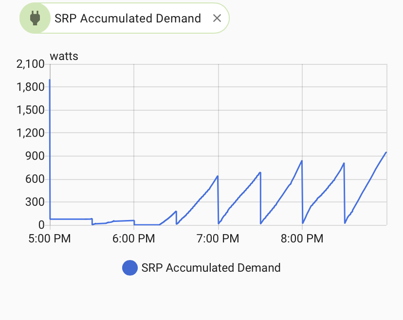

Demand is calculated every 30 min during peak periods. I do have a “demand accumulator” helper that I use for an automation, but I have not attempted to estimate billing costs.
I’m using a node-red flow to update the helper. I found a custom node that integrates kW from my grid-supply and the flow resets it every 30 min. I did not find a way to do this in YAML (skill set limitation, most likely!).
Sensor output looks like this:
The demand for each 30-min window is the peak value at the end of said window. As you can see the accumulated demand looks almost like triangles.
Let me know if you want more detail.
