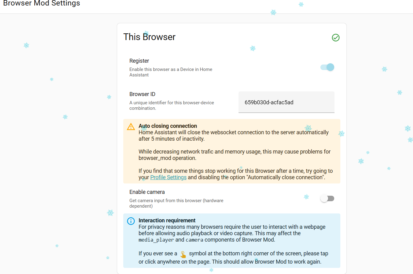

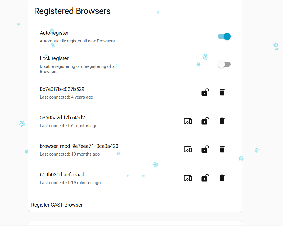

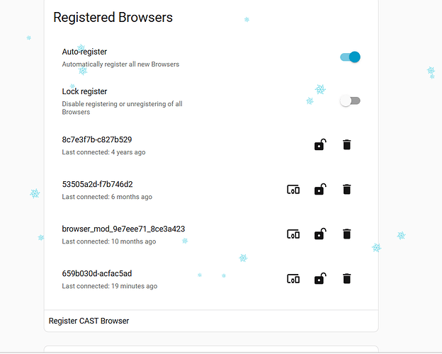

i did what you said toggle the register all browswers… i refreshed things
if i do title and content only content shows up Title text doesnt show up nore the title on my buttons
i guess the target browsers is for different things to show on a browswer? or fit better is that the main reason?

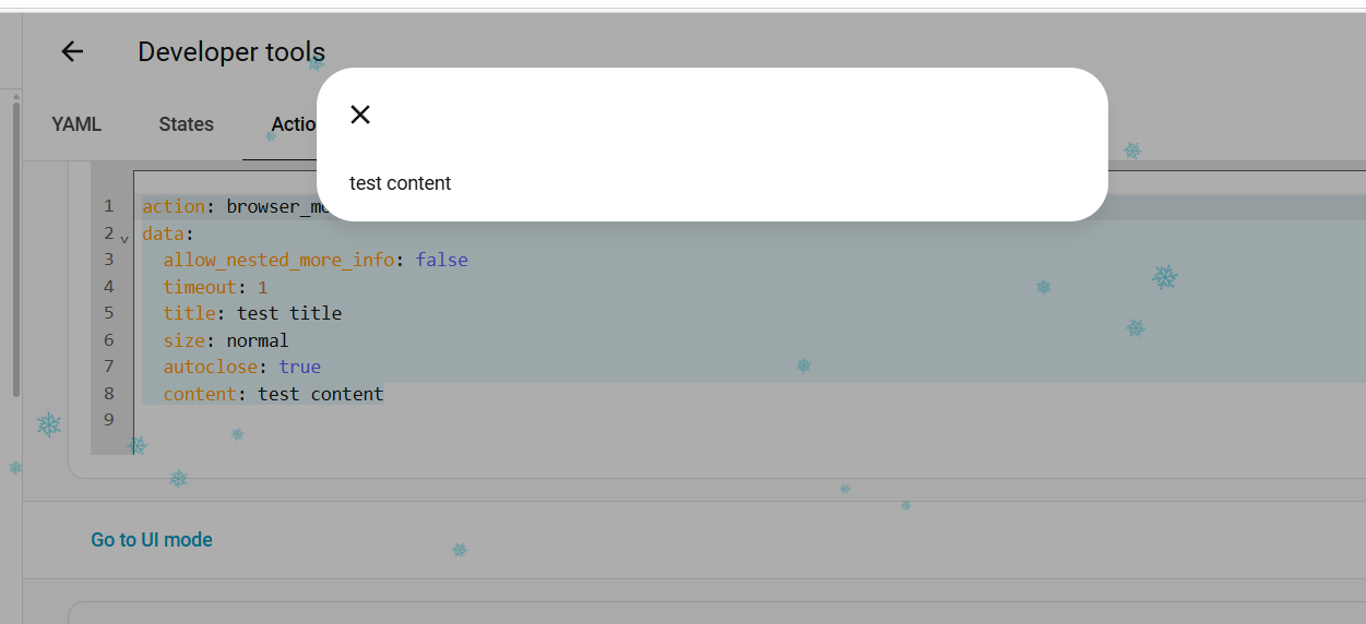

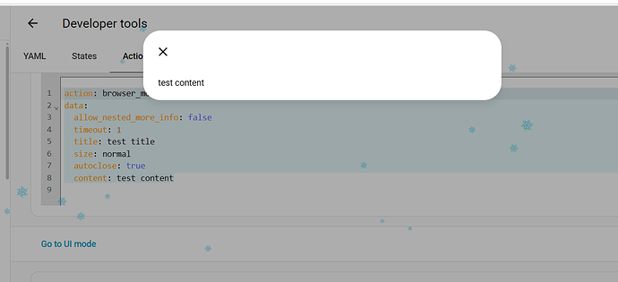

under developer actions
i did
action: browser_mod.popup
  allow_nested_more_info: false
  timeout: 1
  title: test title
  autoclose: true
  content: test content
this is the result… i wanted to also mod my pop ups to auto close after 10 seconds but that timeout isnt working either just sits there

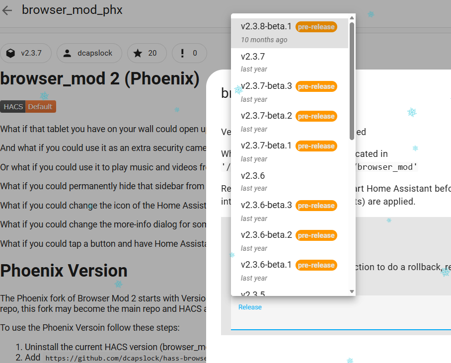

browser mod 2.3.7 thats what the corner says on the hacs / browswer mod
ill upgrade to 2.8 then as its never offered to update
how do you set it so browser mod shows there is an update avaliable?
i only found 2.3.8-beta.1 released 10 months ago is that the one i want? no 2.8
here my my browser page
That is an old fork - that is why you are not getting updates. Remove it from your custom repositories and search again for Browser Mod in HACS
Title will be fixed once you are on latest Browser Mod.
