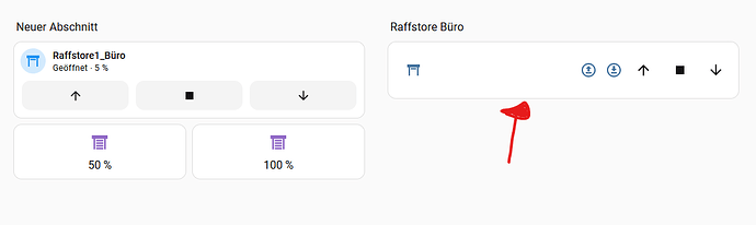

i’m very new to HA, and currently working on automating my roller shutters
To tighten the views a little bit, i am experimenting with paper-button rows, but failing hard…
I want to go from seperate controls (on the left) to a cleaner look which does not require so much space (on the right):
  • The up and down Arrow with circle should control the tilt position (half open / open)
If i press the button, i am getting the following:
“Die Aktion cover/set_cover_tilt_position konnte nicht ausgeführt werden. required key not provided @ data[‘tilt_position’]”

… which are standard buttons.
Are you sure that this custom “extend_paper_buttons_row” thing (which seems to be a custom “paper-buttons-row” does support this format?
Try this:
    tap_action:
      action: call-service
      service: cover.set_cover_tilt_position
      service_data:
        tilt_position: 50
        entity: cover.raffstore1_buro
Thank you! Small change with huge impact :slight_smile:
